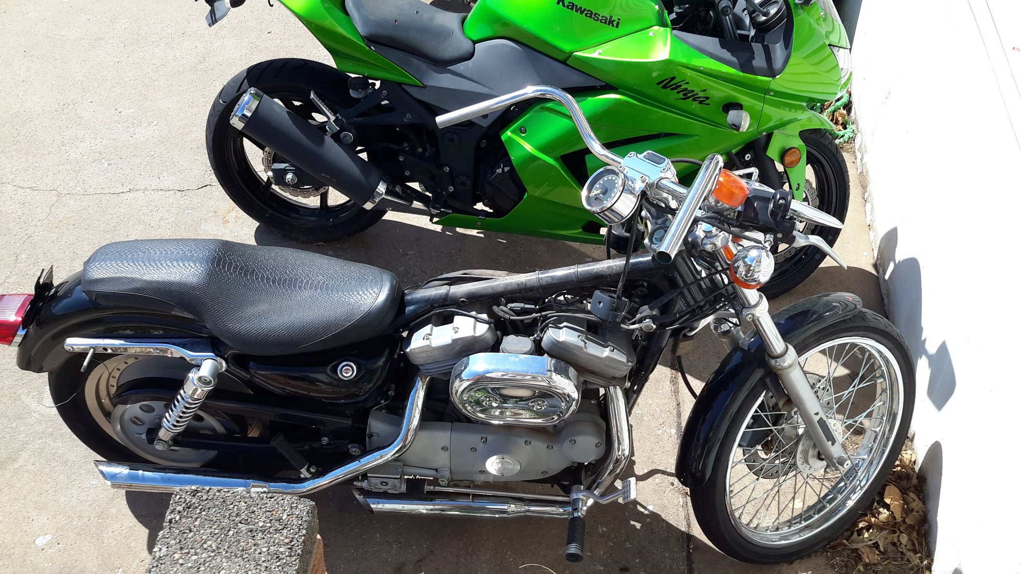

Took off some drag bars and replaced em with some stock fatboy bars(cause I had em).. They have alot of play em, back and forth, I checked the riser bolts to be sure they were tight(they are) so I assume the rubber bushings are worn out.. I'm gonna buy some replacements, just wanted some opinions on stock rubber ones, poly ones, and the solid aluminum ones..
Still cleaning the tank, and also have to extend the wires to the bars, thats why its missing...
