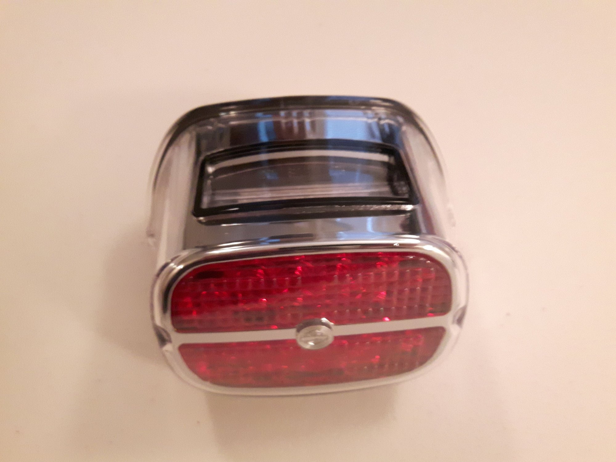

Here are a couple of shots of the Harley Davidson L.E.D. taillight I have and the part number from my receipt for it 68085-08HD.
As mentioned I can’t find it anywhere online.

According to this link, it fits the bikes listed. https://aafes.lvhd.com/products/prod...productID=9988
Fits '99-later XL (except XL883N, XL1200N, XL1200V, XL1200X and '11-later XL1200C), '99-later DynaŽ (except '09-later FXDB and FXDWG, and '14-later FXDF), '03-later FXST, FXSTS, FXSTB, and FXSTC, '00-later FLST, FLSTF, FLSTSB and FLSTC, and '99-'08 Touring models (except FLHX, FLHTCSE2, FLHRSE3/4, and models equipped with Licenses Plate Relocation Kit P/N 53702-04). Also fits '09-'13 FLHRC, and '09-later FLHTC, FLHTCU, FLHTK and FLTRU models.

That looks to be identical with the exception that mine is inverted to the one pictured.
Nevertheless, it looks very promising that mine will fit and quite possibly work.
