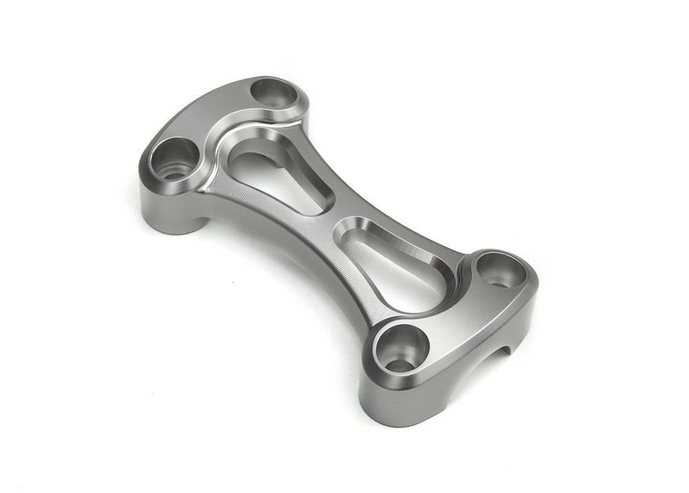

What is a dog bone cover?
carl
I'm glad YOU asked. I don't know either and couldn't find anything about it.

Dog bone....a one piece handle bar clamp. My Freight train Nacelle has a cover that goes over it, held on with two screws
Not mine below....if it were, I wouldn't cover it!
