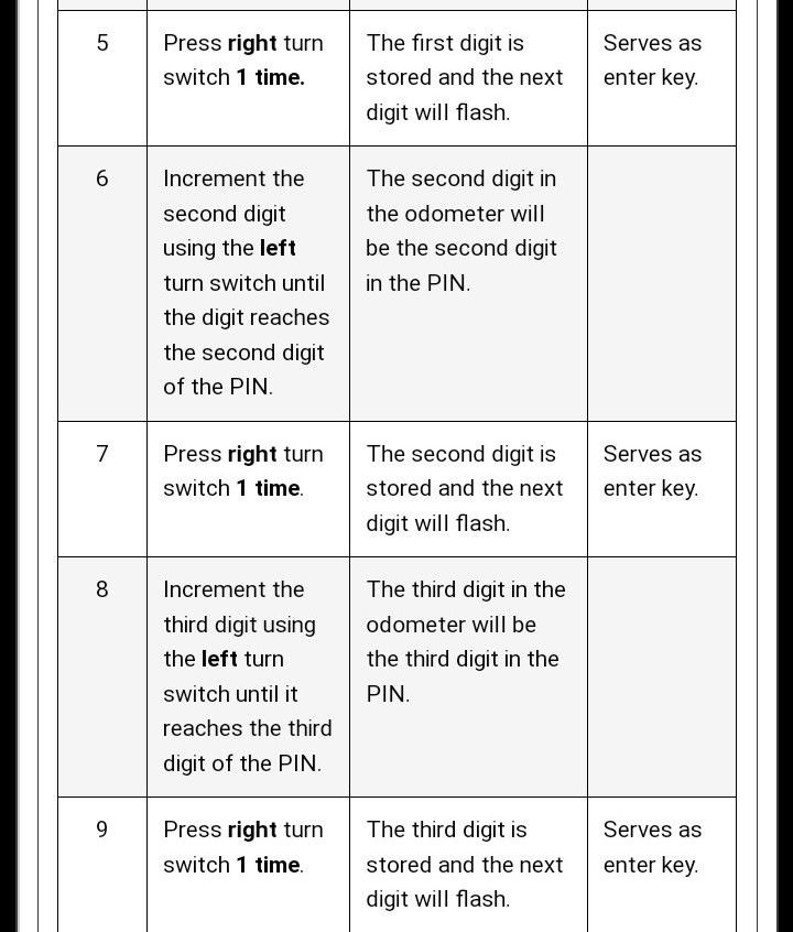

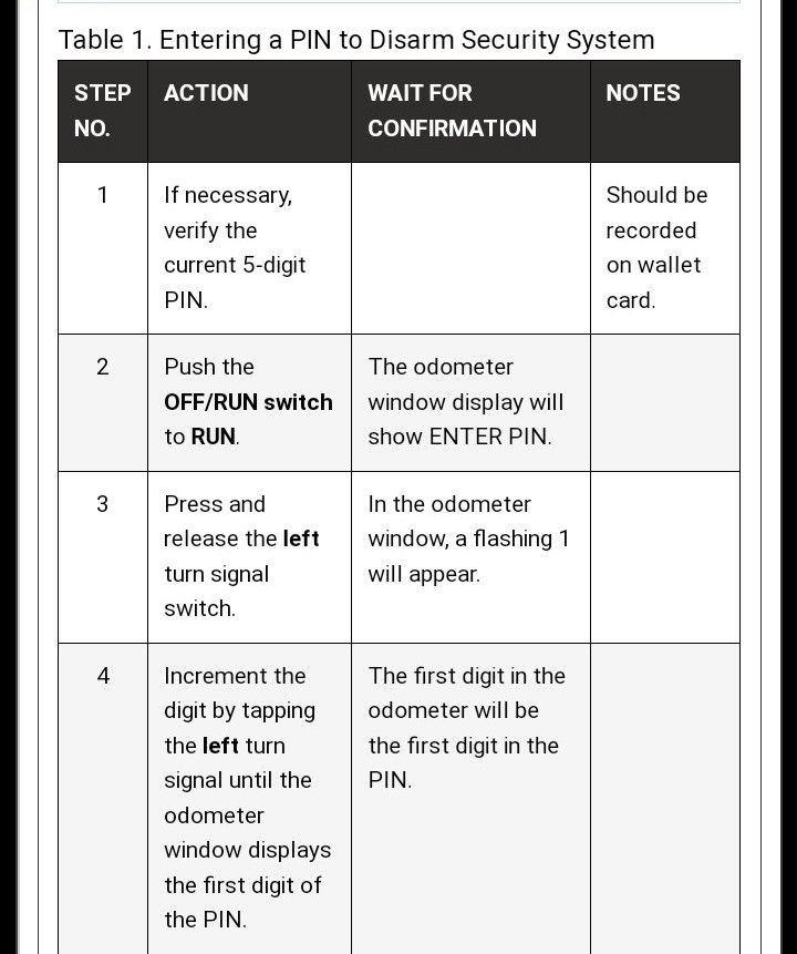

Originally Posted by Jehu
Guys, thank you all for the help.
Disconnecting some aftermarket stuff AND making absolutely sure that the bike was absolutely motionless and still did the trick! Prompt for PIN, entered PIN, good-to-go!
Re-attached everything, followed the above procedure (absolutely motionless) and good-to-go again.
You guys are all wonderful for jumping in with the help.
Much appreciated!
It's good to hear your issue has been resolved. Rounders to the rescue! Without his valuable technical input, there's no doubt in my mind the mystery would remain unresolved.
Much appreciated!
Jehu,
Which fixed the problem: 1 Disconnecting aftermarket parts of 2 Being absolutely motionless??

Originally Posted by barneyboy
That procedure is for pre 2011. Your 2018 should automatically display ENTER PIN when you power up with the fob out of range.
just wondering if i was to put a new one on my bike do i have to take it to the dealer of could i do these steps as well?

Originally Posted by Rustyg500
Jehu,
Both, I think.
Everything is connected as per prior and, if the bike is absolutely motionless, it works!
