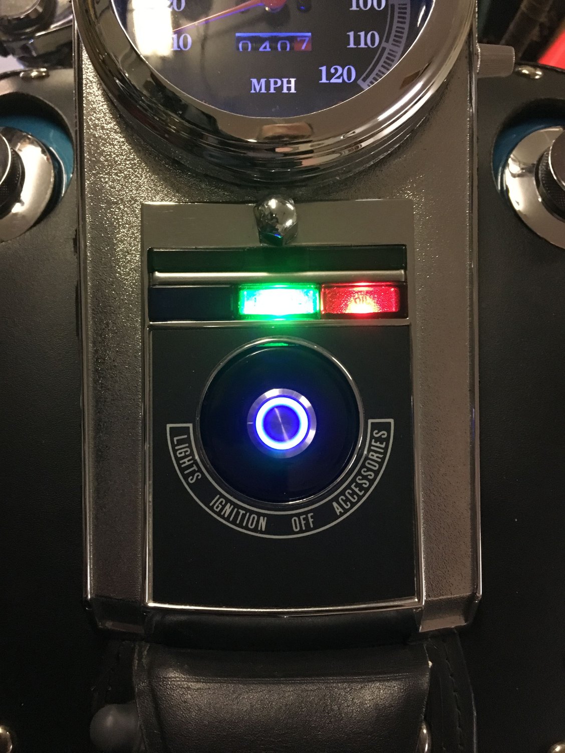

[QUOTE=jamala00;21704083]Only dash lights on my bike are on the tank console and speedo. All those the tank console lights are very dim... I wonder if those can be replaced with LEDs. I might have to look into that.
My dash LED's are so bright they're annoying
Good thing they don't say on long.
I did color LED's to match the lens colors.
I also did color LED's in the speedometer and tach.
