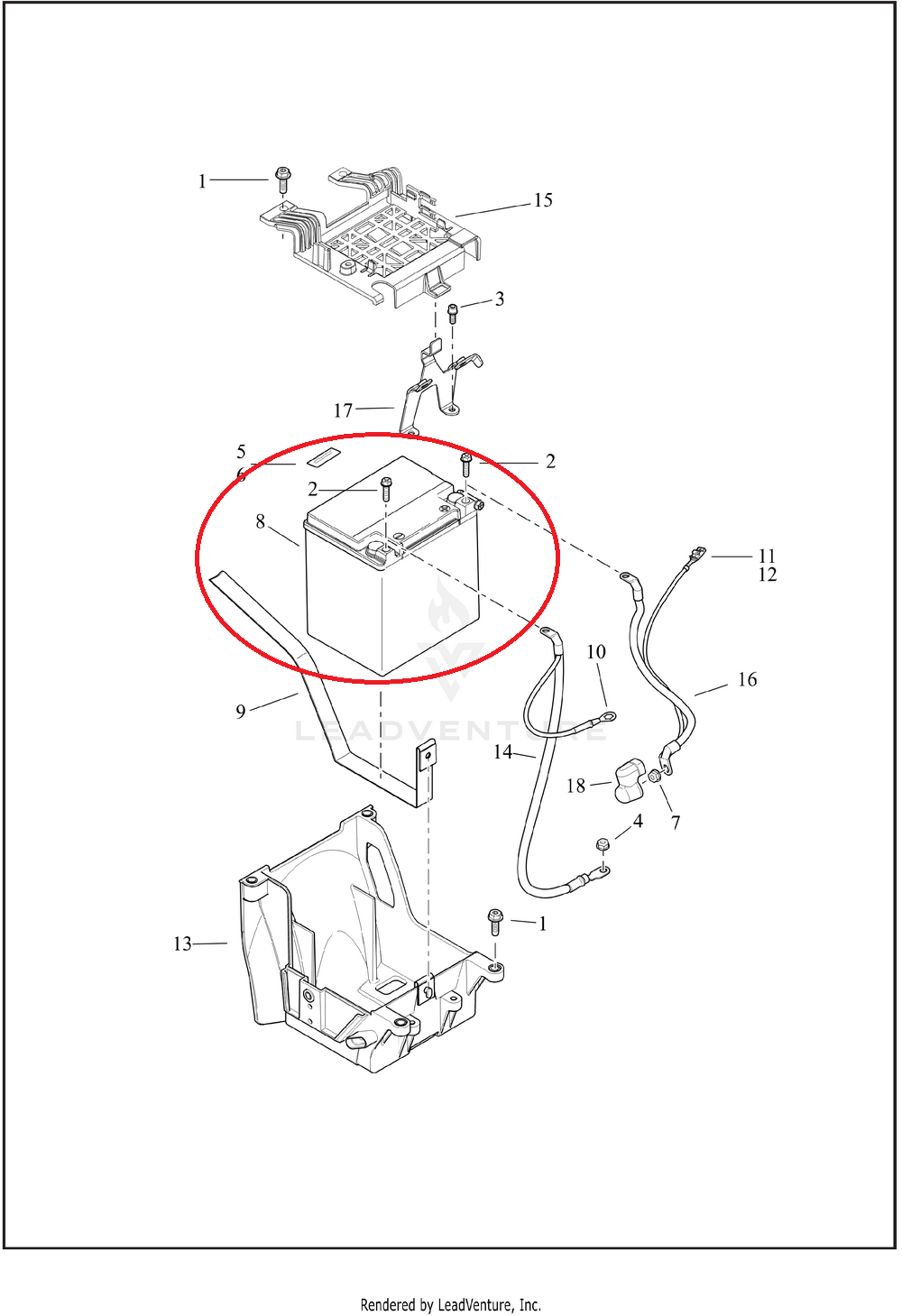

I recently bought a 2024 FLHTP. Would that have come with an AGM battery as OEM? I've had no reason to take everything apart to view the battery myself yet but I have had it on a 1 amp maintainer.
If it was indeed AGM I do have a Prologix charger with settings for Standard/AGM/GEL. But of course that charger only has larger alligator clamps on it, no provision for a pigtail to simply plug into the bike.
Yep a sealed battery, as far as I know all new models will have AGM Batteries.
Ref:8
66010-97E
BATTERY,28AH,SEALED | with 4312C (Domestic)
Price: $219.95
