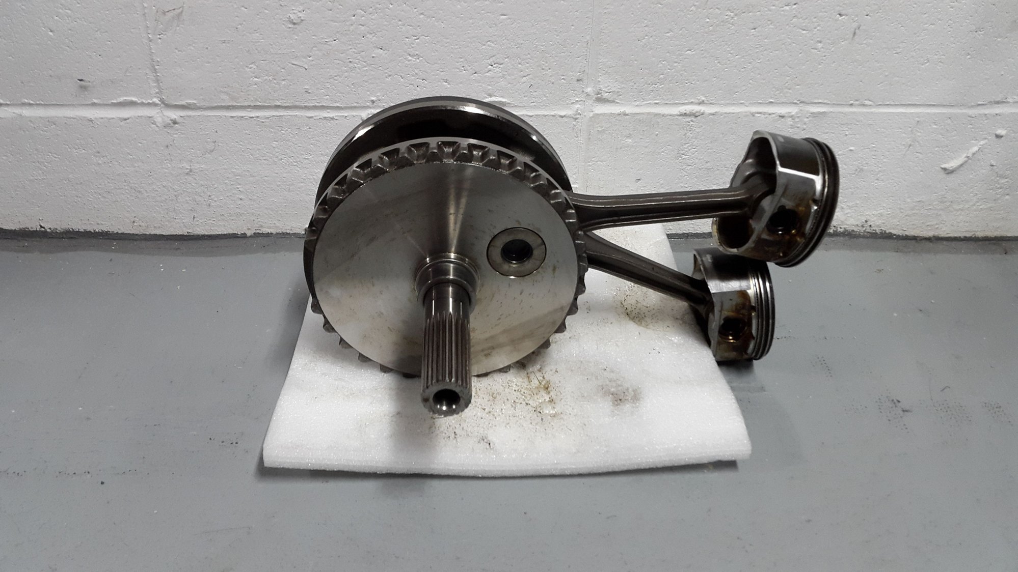

You mean putting a "103" timer cover won't increase the stroke from 4" to 4 3/8" ?????? Just kidding. If it has a 2007 + 4 3/8"crank the sprocket shaft will look like this
If the sprocket shaft looks like this one, he's mistaken or liar.
Easy to check when looking at an engine by itself but your point is definitely made; who knows what's inside, good or bad.
