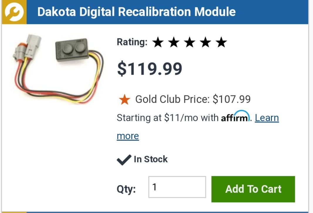

So i did a lil researching and found that there's a re calibration module that can sort my problem out however would appreciate if any of you guys can confirm this?
See oic attached. (I've emailed them but still awaiting response)
Old May 18, 2019 | 01:38 PM
Mattbastard's Avatar
Mattbastard
Joined: Nov 2009
Posts: 4,315
Likes: 1,663
From: Tampa
That's the one I was thinking of. Never used one though, but they do what they say they do.
