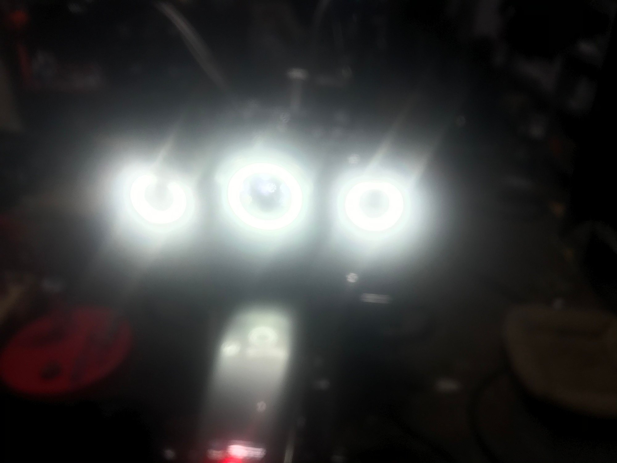

i have an 03 road king which i purchased an arlen ness bob dron fairing for because i hate the batwing . no issues with that fairing other then im not crazy about it that said i went and customized my passing lamp setup and ditched that original bracket with the cross over bar and installed the newer style that dosnt utilize the support bar across the middle . i left off the bottom turn signals and wired the halo rings on the passing lamps to function as running lights & turn signals which came out beautiful so there is only 3 lights up front but that setup dosnt work with bob dron fairing so this is perfect excuse to install the shark nose ive always wanted and to make matters even easier i do not plan to run a radio instead i will be modifying the inner fairing to accept my power vision ,oil temp & pressure gauges , possibly a rear view camera display im toying with idea , an area to accept my phone to fit flush into the inner fairing and some other hidden storage compartments . that said i need to know the following -
can i simply bolt one of the adjustable road glide mounts to my RK frame and install the inner / outter fairing along with head lights seeing as im not looking to wire in audio system and any additional wiring i will hardwire in myself ?
without overly complicating i need to know which mount or brackets are needed & how do they attach?
can i use any year shark nose or am i stuck with certain years only ? reason im asking there is an aggressive aftermarket road glide fairing i want to run if im dropping the coin id like to do it the way i want it from jump street!
also has anyone run into negative affects related to handling? i believe i read something about wind buffering i could be mistaken ?
i do not want to have weight of fairing resting on the forks i want it all mounted up solid to the frame ! i hope i made sense and some of you who have done this project can easily guide me ! im painting bike in a few months and want to get everything fitted and correct before going into paint . thank you any input is greatly appreciated ! below pics of bike old style passing lamp with fairing and the new style no fairing .
