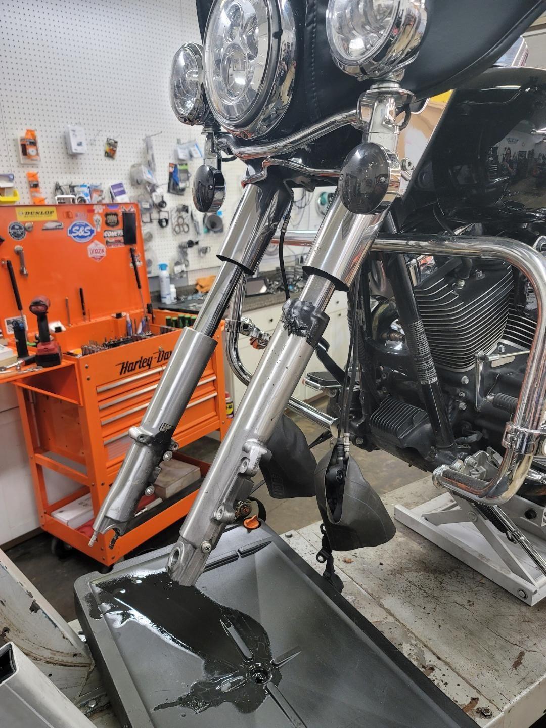

I found a small puddle of oil on my front wheel. It was on the right hand side of the bike. It's dark in color, and I noticed some on the inside of my Arlen ness Forks right below where the caliper bolts attach to the forks. I have a 15 street glide with 46,000. I's assuming its fork oil. Any other ideas?

Problem Solved! Thanks for your input. Pulled the forks and I could clearly see the oil seeping out. Took them to Harley and 400.00 later, I'm back in the game.
