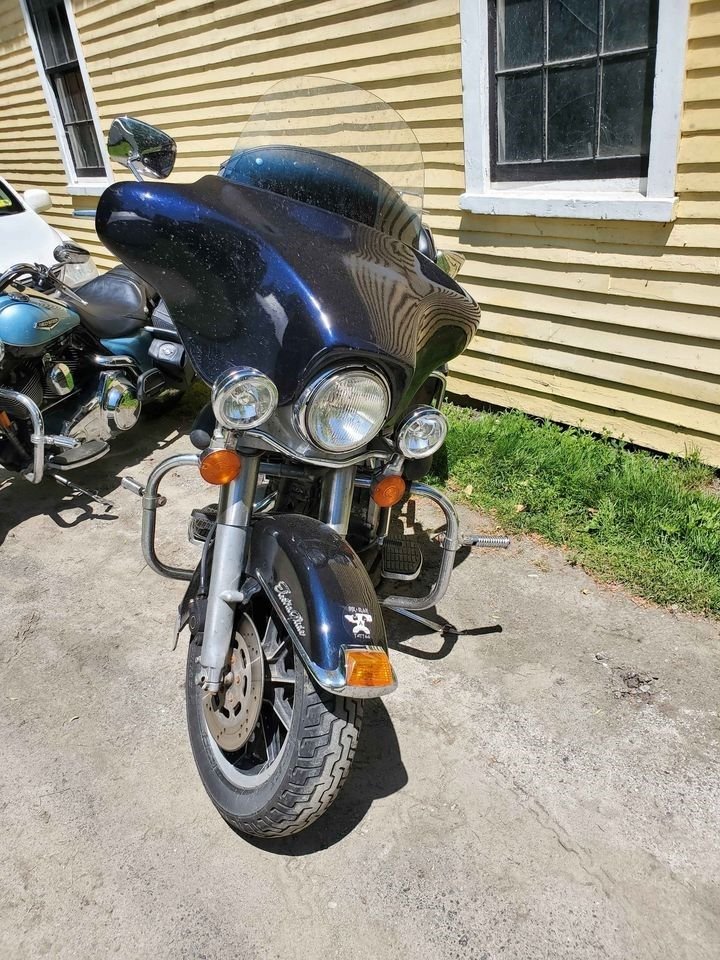

Greetings, Can anyone help me out wit some information. I bought an 87 electraGlide Sport and it needs some work. I bought all the parts, but I don't have the tools. Stator. Rear tire. Brakes front and back. (Just pads for now) Wheel bearings repacked, but I bought new ones seeing I'd be in there anyway. Front fork rebuild. And converting from the Zenith carb to a CV40. What exact tools will I need for the above jobs? I don't want to spend several hundreds of dollars on sets to get 1 tool. There is a used tool seller close to me and if I can, I'd rather buy single tools specific to this bike so that when I need them, I'll have them. I'm 56 and this is my first Harley. I'm excited to get this thing done. Thank you for any and all reply's.
It's dirty because the last owner stopped taking care of it. Next spring it will look much better.
Thanks again.
