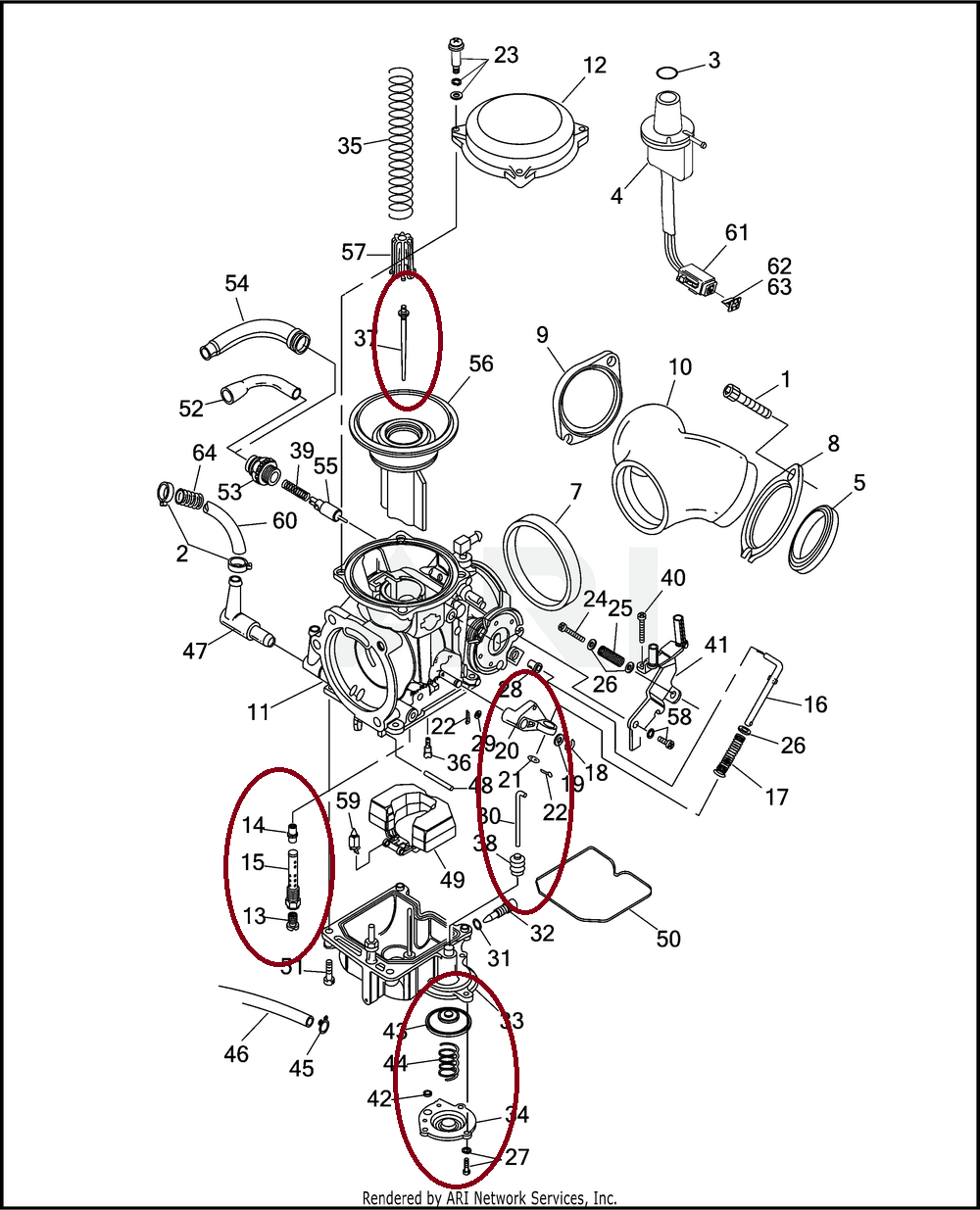

You probably need to revisit your carburetor, and make sure everything is clean and your float is adjusted correctly.
1. Do you have a factory service manual for your bike?
2. Did you buy a quality rebuild kit for the carburetor?
3. How deep did you go with the rebuild?
4. Need to make sure your jet needle, needle jet, needle jet holder and main jet are all very clean and all the orifices are clean.
5. If that all was accomplished, the most likely place is the accelerator pump area not together correctly or some blockage.
