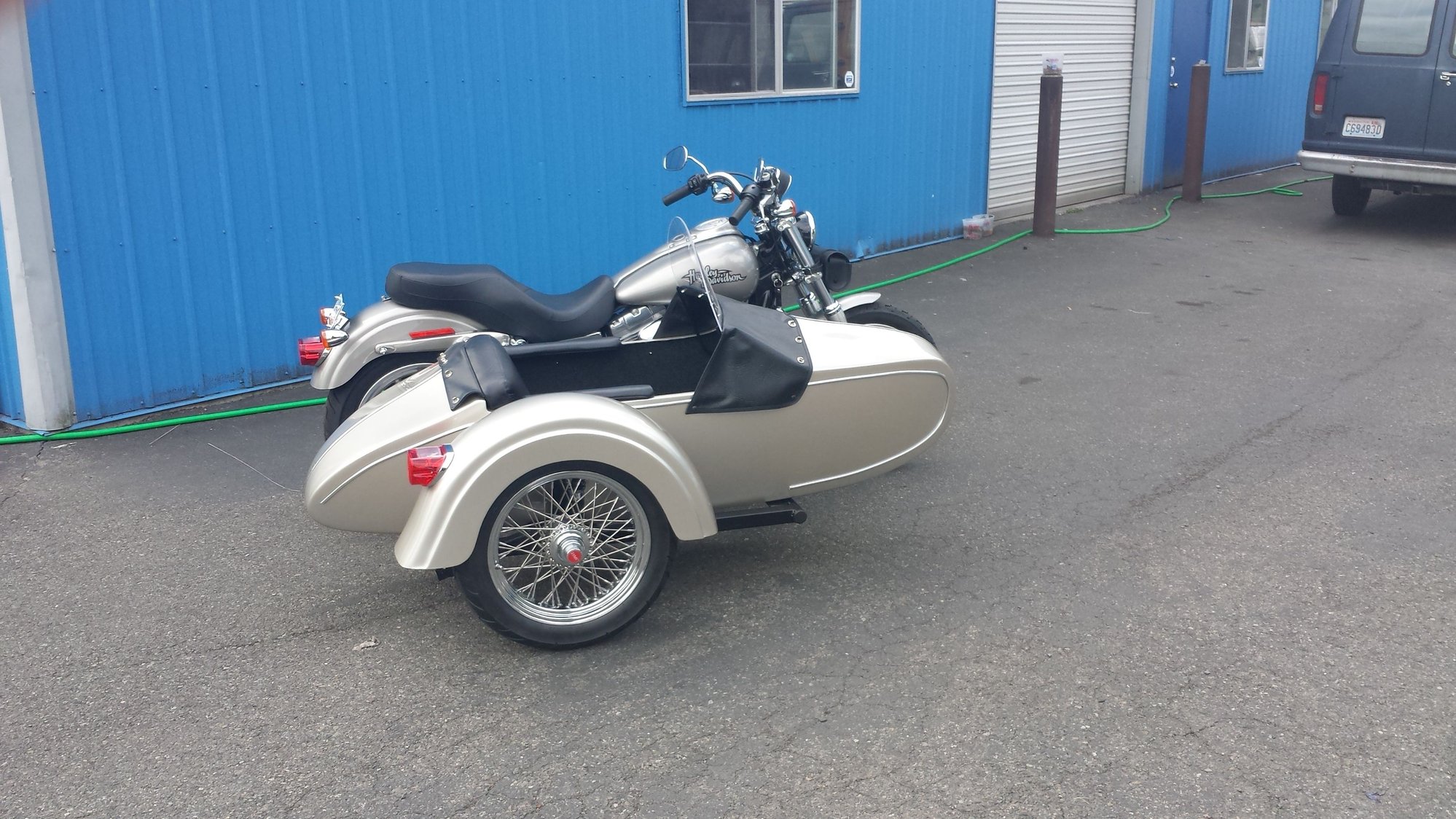

First, let me proudly display my newest "rig" She is not my first in the last 22 years of sidecars, but this is an absolute dream to ride. DMC Classic on a 2009 Dyna
2009 Dyna with DMC Classic
Alli-Gator's first ride 6 Months old.

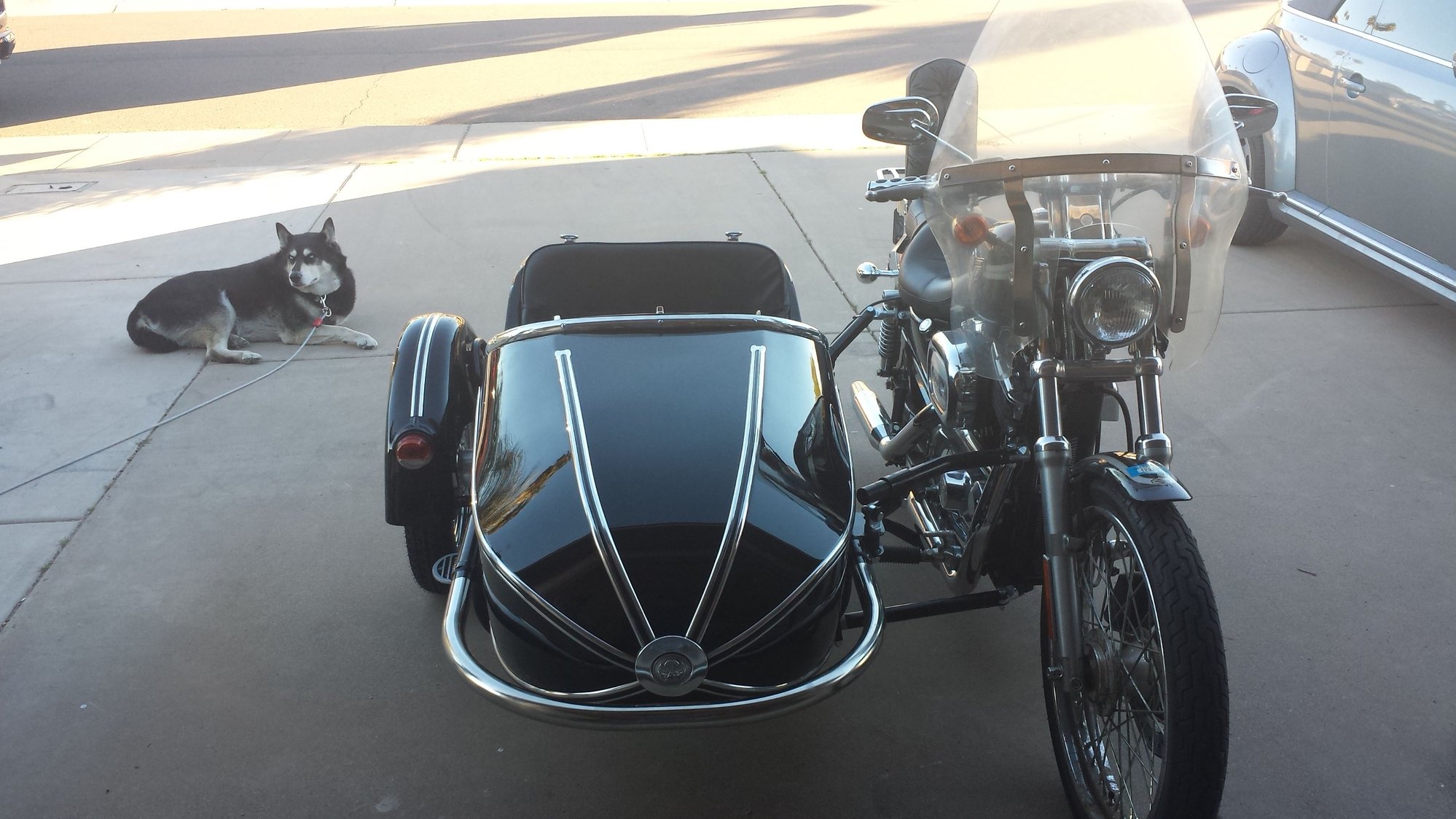

lean should be 1-3 degrees most of the time so that when rider sits on the bike it comes back to zero. First thing I would do is the Dampener. It make a lot of difference on the 1996 FB with low speed wobble. It is not dangerous, just spooky at first. . Smaller light bikes can often do with out a raked tree. This is a bracket that was make in rought form for the Street. It mounted to exhaust mount and ran forward to foot peg mounts Took a hour to make once it was what was needed welded all seams. Did something like it on the FB also. The lower rear mount needs to be as far back as you can get it and a close to straight across from the frame. 14 1/2 inches is a bit forward of the rear tire but some thing you may getaway with. Generally farther back the more stable at slow speed the farther forward the better at high speed.. It would be great if it was one hard fast rule for everything , but it don't work like that.
Looks good, it does not always go prefect first ride out the door

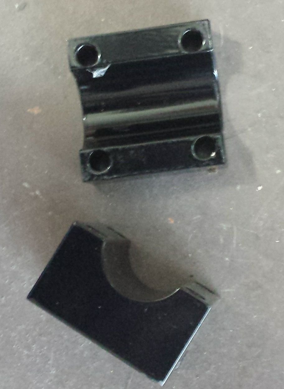

The rear lower comes from the rear most part of the frame, angles downward under the exhaust, then over to the block. The way Watsonian attaches leaves little room for adjust ability. The tube is captured by a squeeze block that holds the tube 90 degrees from the sidecar. I would need to set up some angle-dangle-sort of mount. I think NOTHING is impossible in the sidecar world. (Ha, I remember riding from Texas to California with a bungee cord wrapped around my footpeg and handlebar as kinda of a old school damper).
Thanks again
Watsonian "Block" system. Not all is shown. One tube cutout goes over the sidecar tube frame, then a perpendicular tube cutout captures the tube coming from the bike.

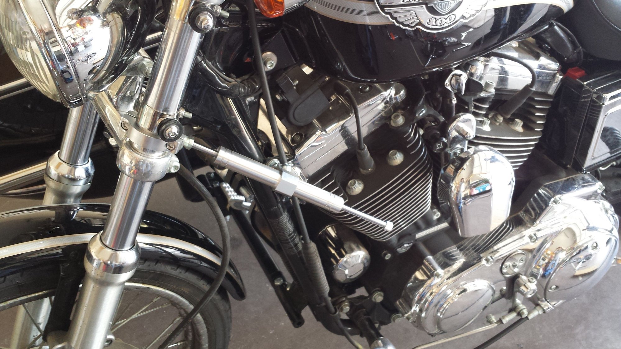

The fellow I am helping ordered a steering damper from Amazon. Today, I helped with the install. I test drove the rig before and after.
The Before: I did not really detect a huge wobble. Seemed pretty mild, and as usual very predictable. Maybe my old crippled body does not bend so much as to notice things like this anymore. I, like many of us, have been around when dirt bikes had steel fenders (until they had no fenders). Flat tracks were for turning left only (unless you had a real big wobble that slapped the tank to the right, then you were mostly off to the hospital in a 4 wheel vehicle. I took the bike to around 70 MPH and threw it into corners. It all went pretty well. (I realize the words "Pretty Well" in the context of sidecars, sometimes means....I survived!
The After: I have to admit, the shimmy, that I did not notice was less noticeable. Actually I have to admit, it was a better experience overall.
Conclusion: I got back on my Dyna rig and scrubbed down the street. I think that their might be a place for Dampers. I doubt I will install one on my rig presently, but I will be more open to the idea in the future. The fellow who owns this Watsonian rig is ecstatic. His level of "Sidecar Joy" has increased 10 fold. That is never a bad thing.
