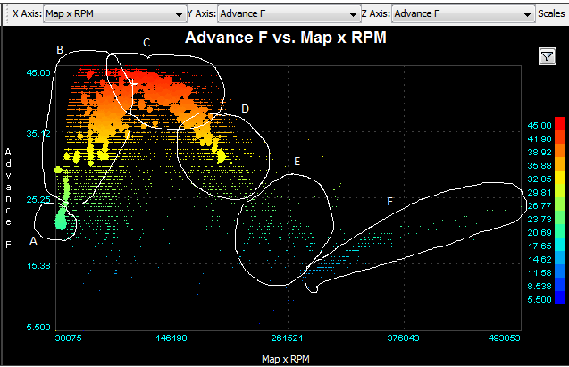

Let's see if we can get this thread back on topic.
The areas of the plot appear to be:
A) Idle area
B) Easy Accel, Decel, cruse under 3k
C) Easy Accel, Decel 3k range, high RPM Decel
D) Cruse 3k range, Accel under 25% throttle
E) Medium Accel 3k range under 25-30% throttle
F) Accel 40-50% throttle
G) Accel over 50% throttle
Still trying to determine what the pattern meansP { margin-bottom: 0.08in;determine what the patter means
