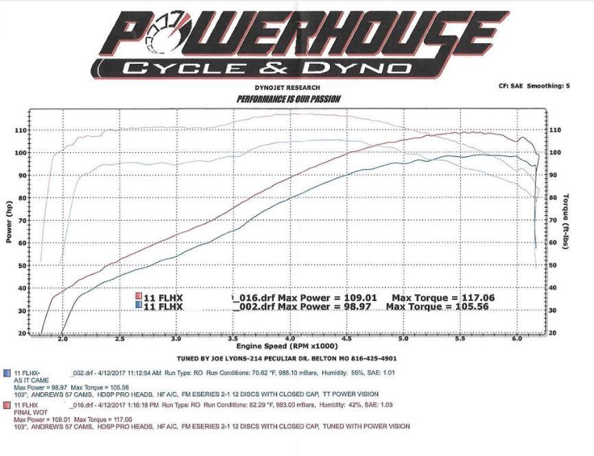

They are a great tool to have and if you take the time to learn it, it can do many things for you. There's always a however though. In my experience it will not take the place of a talented dyno tuner that knows what he's doing. Below is my 2011, 103 that isn't stock and the tune had probably 15 autotune sessions on it. That condition is the original run blue lines. The red is what he got beyond the auto tuned tune. Just a comparison like you asked for.
Your able to add that tune to the PV correct? I'm gonna have it dynoed when I do cams. I just wanted something that would get me through stage I for now.

Picked up quite a bit of torque there!
