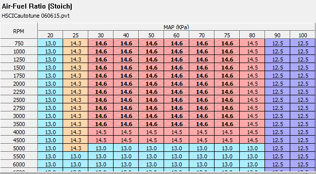

Re-routed my Powervision cable away from the coil and spark plug wires in a attempt to eliminate gauge data disappearing and screen freezing.
Was able to utilize snipping tool to get an image of my map...did not even realize windows had that tool, learn something new everyday.
Since Jamie at FuelMoto offered to adjust my autotune map to eliminate my decel popping, sent the map below.
Just an update: Re-routed my Powervision cable away from the coil and spark plug wires in a attempt to eliminate gauge data disappearing and screen freezing.
This fixed the problem...no freezing-no disappearing gauge data. Ran bike for about 1 1/2 hrs continuously and the gauges worked properly, although the ET went up to 430 in stop and go traffic doing it...lol
