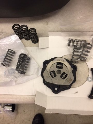

Here is the clutch mods I am using, so far

How is the clutch level pull with those springs?

It's hard to tell from that pic how the length of springs compare, but the orange springs that came with mine are shorter than the stock ones they replace
