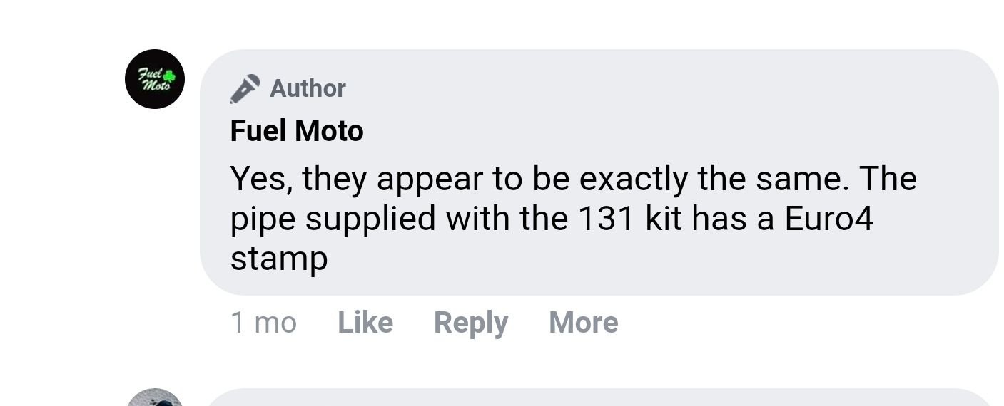

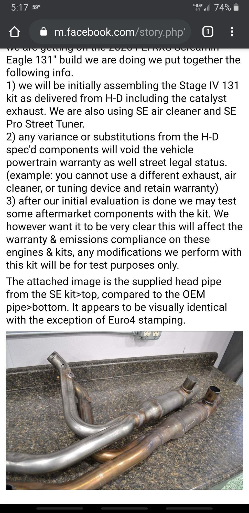

From Fuel Moto, they say its identical to the regular stock header....

The difference is on the inside. I can’t find the post but the cat is different. It’s high flow and has a different look. Someone posted a picture of the cat.

I do not know, just going off of their response, maybe the OP can reach out to FM and get a better understanding

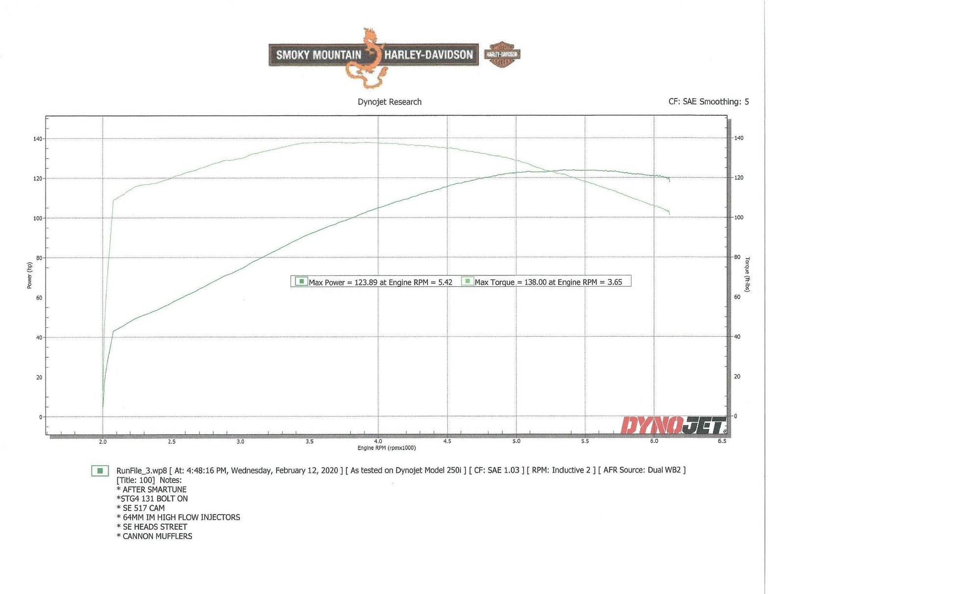

The pipes are the same dimensions but the kit pipe is supposed to be less restrictive. Over the past few weeks I've put around 1000 miles on my 131 kit and am pleased with how well it runs and overall performance for an EPA compliant engine. I put the SE Street Cannons on mine and sound is decent.

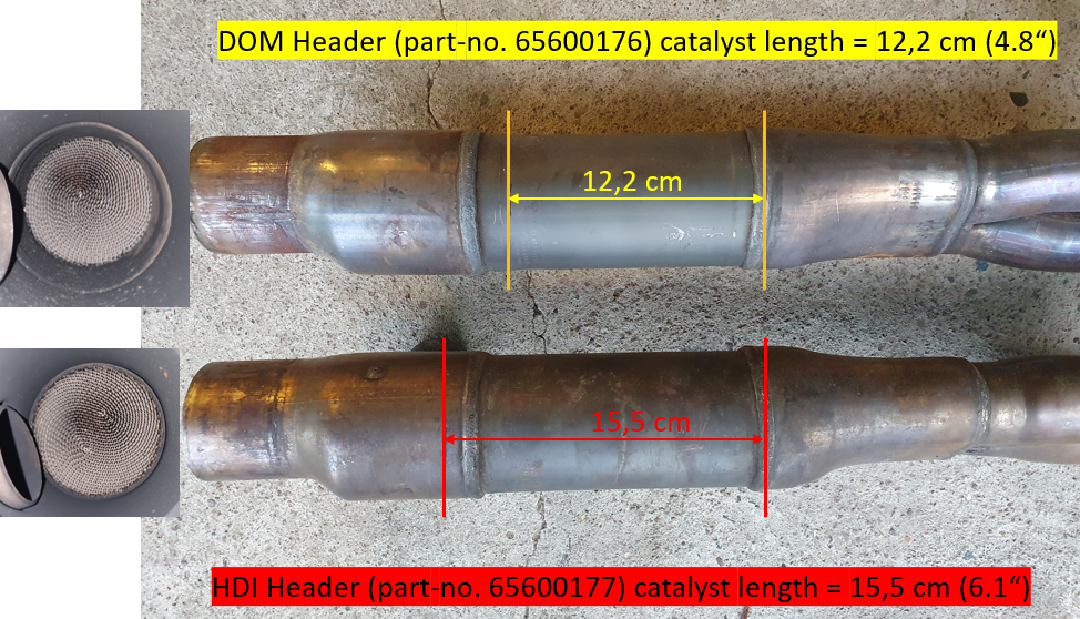

Meanwhile I could compare an DOM header with an HDI (Euro4) header (that is also used in the SE 128/131 Stage 4 Kits):
The catalyst in both headers seemed to be of the same type (metal cat, S-/ HF-design with 400(?) cpsi (cells per square inch)).
The difference is the length. The length of the cat in the HDI (and stage 4!) header is 15,5 cm (6.1") and the length of the cat in the DOM header is approx. 12,2 cm (4.8").
As mentioned, I recently decated a HDI header (the quote "DOM" in my last post was a typo), so I know that the cat starts at the first weldseam.
For the comparison I assumed that the DOM cat starts at the weldseam also. But it might even be shorter when locking at the first post of this thread:
https://www.hdforums.com/forum/milwa...394-decat.html
This means, that the cat in the HDI/Stage4 header is at least 27% longer!
I read some technical/scientific essays reg. cats and they quote that the length has a linear influence on the restriction.
This would mean that the cat in the HDI/stage4 header is at least 27% more restrictive than the cat in the OEM (DOM) header!
So with my guess that HD used the more restrictive Euro4 header to meet EPA regulations I seem to be on the right track...
