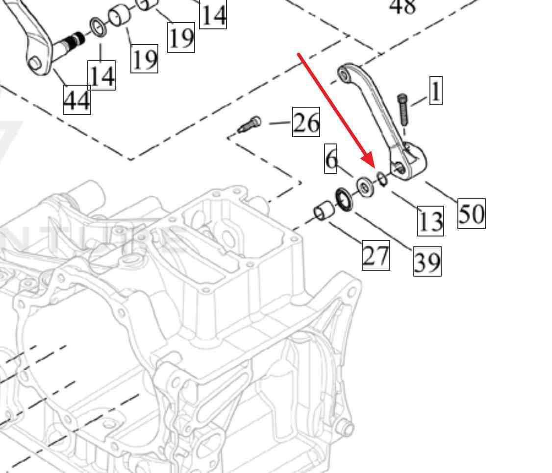

There is axial play on the shifter pawl shaft, a few mm in and out. No idea if this is normal.
I can recreate the problem shifting by moving the wheel back and forward.
When the downshift is normal, there is an audible click when the shift lever is released and returns to its centred position.
When the problem occurs, there is no audible click, the lever can be depressed, it just moves down and returns under spring pressure. Turning the wheel has no effect on it in this state (as in the small amount of rotation possible in gear).
If i pull the lever attached to the shift pawl out towards the primary, you get the audible click, and the next press on the lever will select the next gear down as usual.
Is this suggesting the shifer pawl/bushings are worn and/or binding?

I'd be more inclined to believe that the shaft snap ring popped out of it's grove and when downshifting the shaft is moving enough for the pawl to bind. You should not have 2mm axial play. Should be something like 0.3-0.5mm.

Thank you. Looks like i better pull the primary off and have a look.
