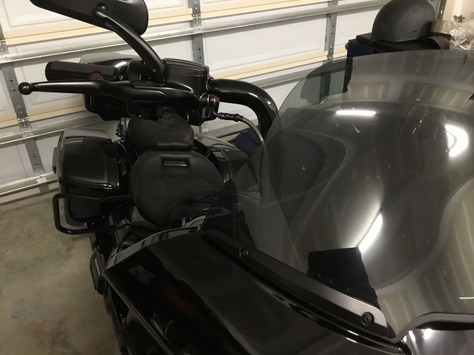

Here are a couple of pictures, garage is still a mess from moving and Christmas. My work space has been greatly reduced.

Looks great, glad you got it worked out. Enjoy those bars!

Those bars look good; definitely on my short list. Are those 12" ?
The wrist angle looks better than stock. What do you think of the width ?
Thanks
