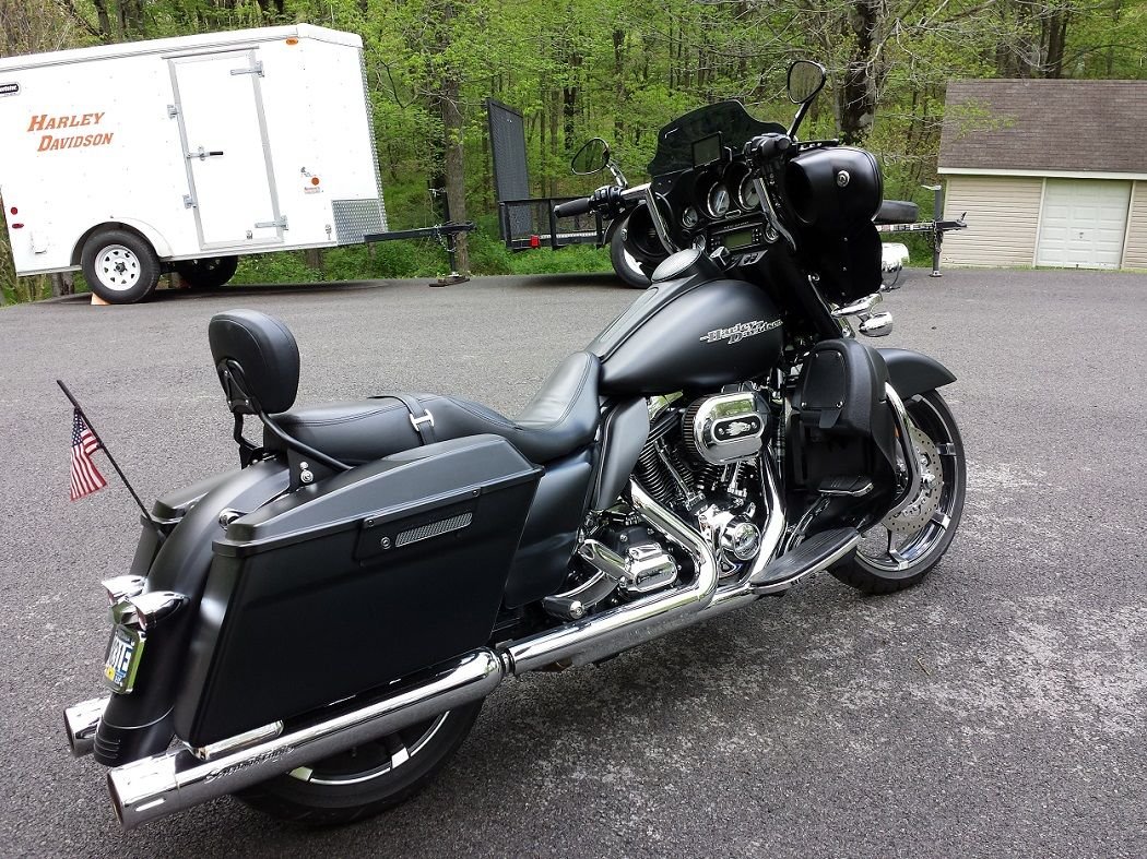

I have 10" LA Chopper bagger bars and I had to relocate gps mount to center of gauges with an Iron Aces mount. Cant tell you about the Wild 1 bars.
new vented lowers

Awesome looking bike ! How do you like those LA Chopper bars? I had the Wild 1 10” on my Street Glide and was really happy with them. Do you find those bars to have enough pullback ? They seem very upright and close to the inner fairing.
I love these bars. Completely did away with my shoulder pain.
