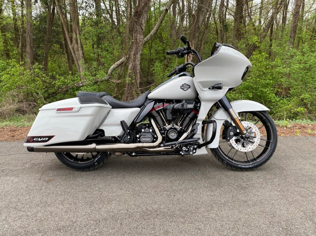

So if I understand, the yellow arrows are pointing to the lifters and the blue arrows (pointing to the long chrom pencil looking things) are the push rods? Is this correct? So If I change out the pushrods, I could get them in gloss black? Do the lifters come in different colors? Which sets do you guys recommend for changing both out? S&S?

Is there a way to get a set like the 2020 RG CVO set up.
Anybody know how to get a set of push rods and lifter covers that match the 2020 CVO. I would like to match my stock heat shields that will be reused. This would be cool. Or if not what is recommended for all gloss black. Anybody have brand and part numbers? I am looking around, but haven't found anything.

What sets for pushrods and lifter do you recommend @Quik ? If I am changing them, I would like to get rid of the chrome and go gloss black, unless I can get a set that matches the stock heat shields...

In my experience you can't go wrong with S+S premium lifters and quickie pushrods, S+S is quality stuff. As far the covers, they have nothing to do with the lifters and pushrods, they are just that, covers. You can either resuse your stock ones or HD makes gloss black or chrome and possibly other colors but not sure on that.

The yellow arrows are pointing to the lifter blocks, the lifters sit just under them. They can be changed to black. The blue arrows point to the push rod covers, and they can be changed to black. The picture below is when I was putting mine back together. I changed them both to black.
