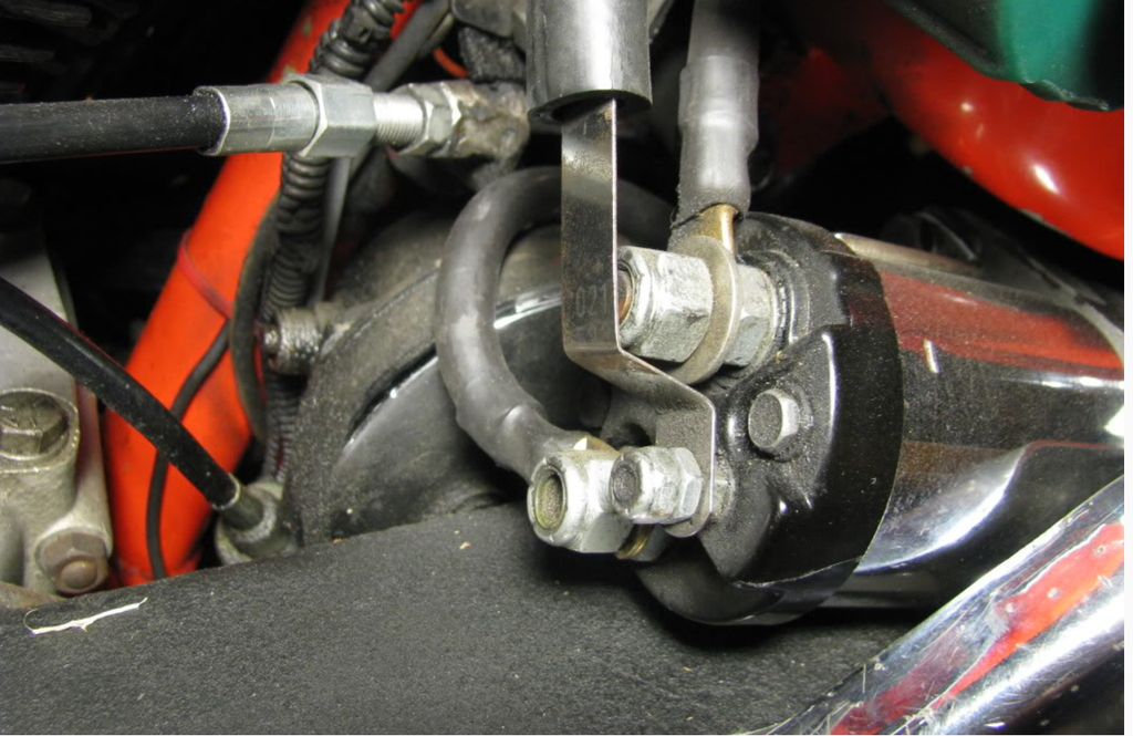

Default Best emegency start button for a shovelhead
Old Jun 24, 2017 | 08:31 AM
Rusty Axle's Avatar
Rusty Axle
Joined: Jul 2016
Posts: 241
Likes: 33
From: Syracuse IN
Now that is clever...
