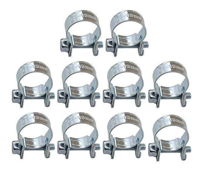

you can use automatic transmission hose, too.
fuel injection hose clamps won't dig into either type hose. I got them from Amazon:

Sounds good. I really like those clamps. Will order some for sure. Thanks for the help.
