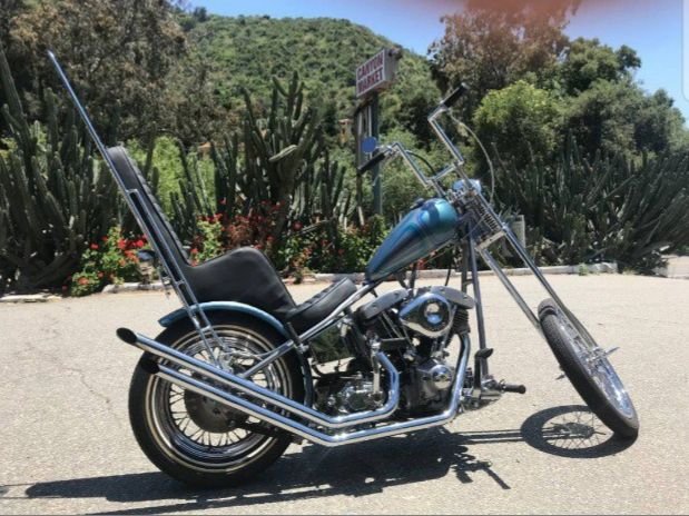

So, I've ridden evos since I was a 14. Getting back on the bike, I decided to go with a Shovelhead project that turned out pretty good (if I do say so myself). However, the eliminator I have on the bike now is not doing it for heavy traffic days - even after trading in for a fancy cable, making all the proper readjustments, and starting a forearm workout regimen. So I think its time to reconsider.
FYI: Its a late-78 FXE-1200 with a rachet 4-speed and primary belt
From my research, I've narrowed it down to two options: old school mousetrap or diaphragm clutch conversion.
Mousetrap
The first benefit of this is, of course, the old-school look. As you know, these later-model Shovies did away with the mousetrap for the eliminator which I currently have. Installing it may require some fab work, but because its a ratchet-4, I figure it will be a minimum. I don't have much experience with these, but to me the installation seems simple enough - I think I may even be able to keep the clutch arm I used with the eliminator. Do y'all have any experience retrofitting these? Any problems you can anticipate? Also, will I be able to keep my current plates?
