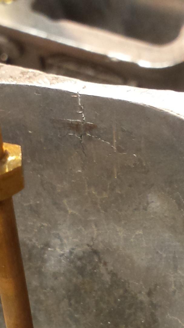

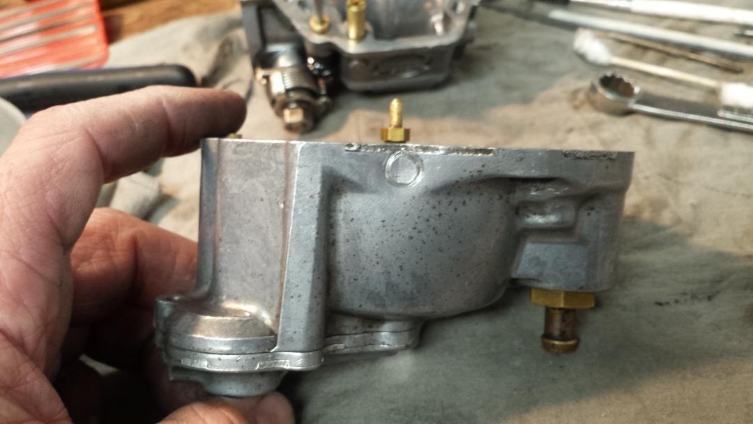

Update: was having issues finding the correct jets that didn't pop, cough, choke, fart or sneeze. Tried everything from .068 thru .076 (main) and .028 thru .033 (pilot/intermediate). Got everything from 'too lean' and 'too rich', but the popping, coughing, choking, farting and sneezing continued. So i called my friend that gave me the carb (directly off his TC because he's going with CV). Now he tells me it sat for 3 years and he didn't rebuild it before putting it on his bike and he was having the same problem.
In the process of a complete teardown and cleaning of the carb I found a crack in the float bowl. Not sure if this was existing or if i did it. Too long of a mounting bolt. Just can't believe i didn't notice it as many times as i removed the bowl

2 things -- the bottom manifold bolt is too long or the spacer was not added
and your intake is suspect as one jet change will change the mix and your 5 away 00 don't care is seems ok its not

$150 for super E float bowl?
