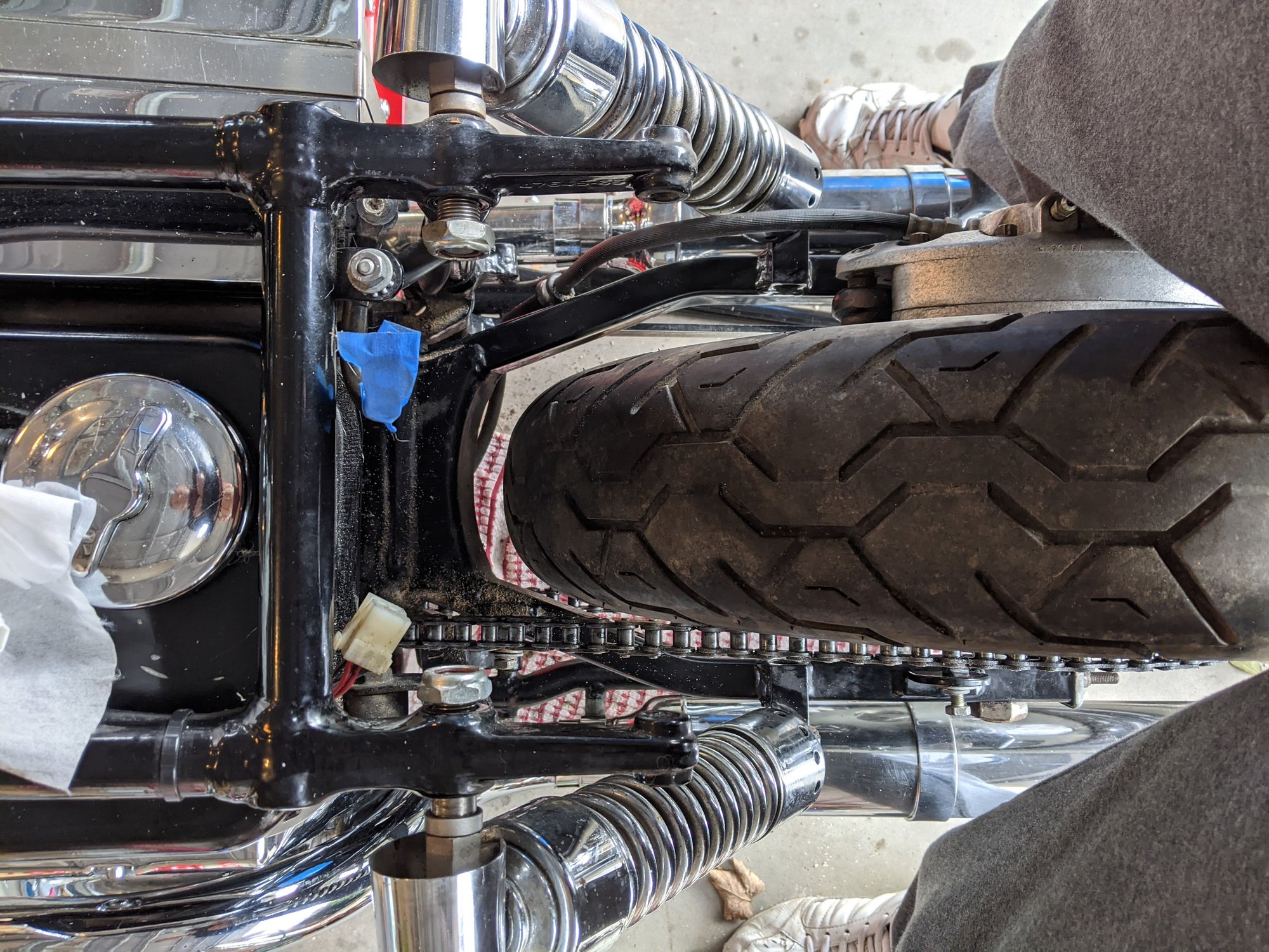

Just for giggles, here is a shot from above...

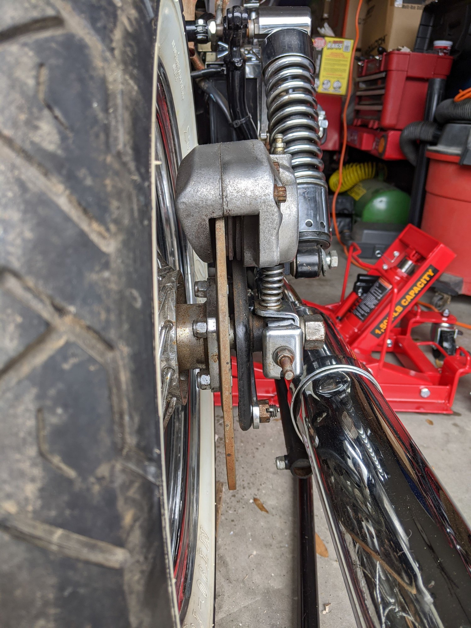

Take some pics of the wheel (axle) spacers and also the rotor and sprocket mounting. Are there spacers on either? Is the sprocket dished one way or the other?
Old Apr 9, 2021 | 10:39 AM
  #68
rickss69's Avatar
rickss69
Joined: Jun 2011
Posts: 2,158
Likes: 35
From: Gulf Breeze, FL
Drive sprocket appears to be slightly dished. Chain and brake disk are running true with no spacers between them and the wheel hub...these do not need any change in position. It is the wheel hoop that is offset to the left which creates conflict. The actual axle spacers are approximately 7/8" on the left and 1/2" on the right. There is no room for adjustment on that front as the bolts for the disc would be at risk of interfering with the caliper bracket.

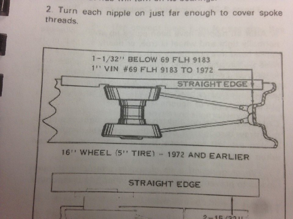

Mayne this helps:
