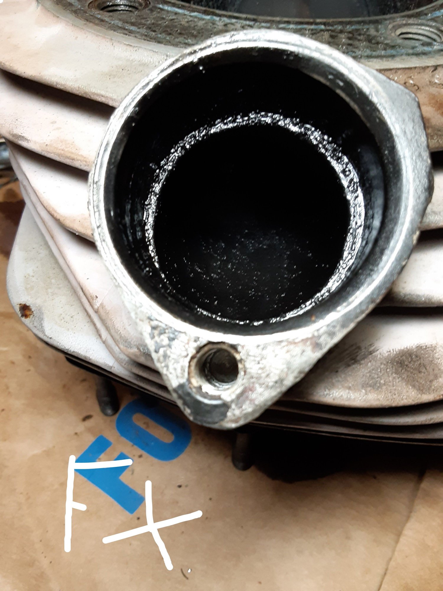

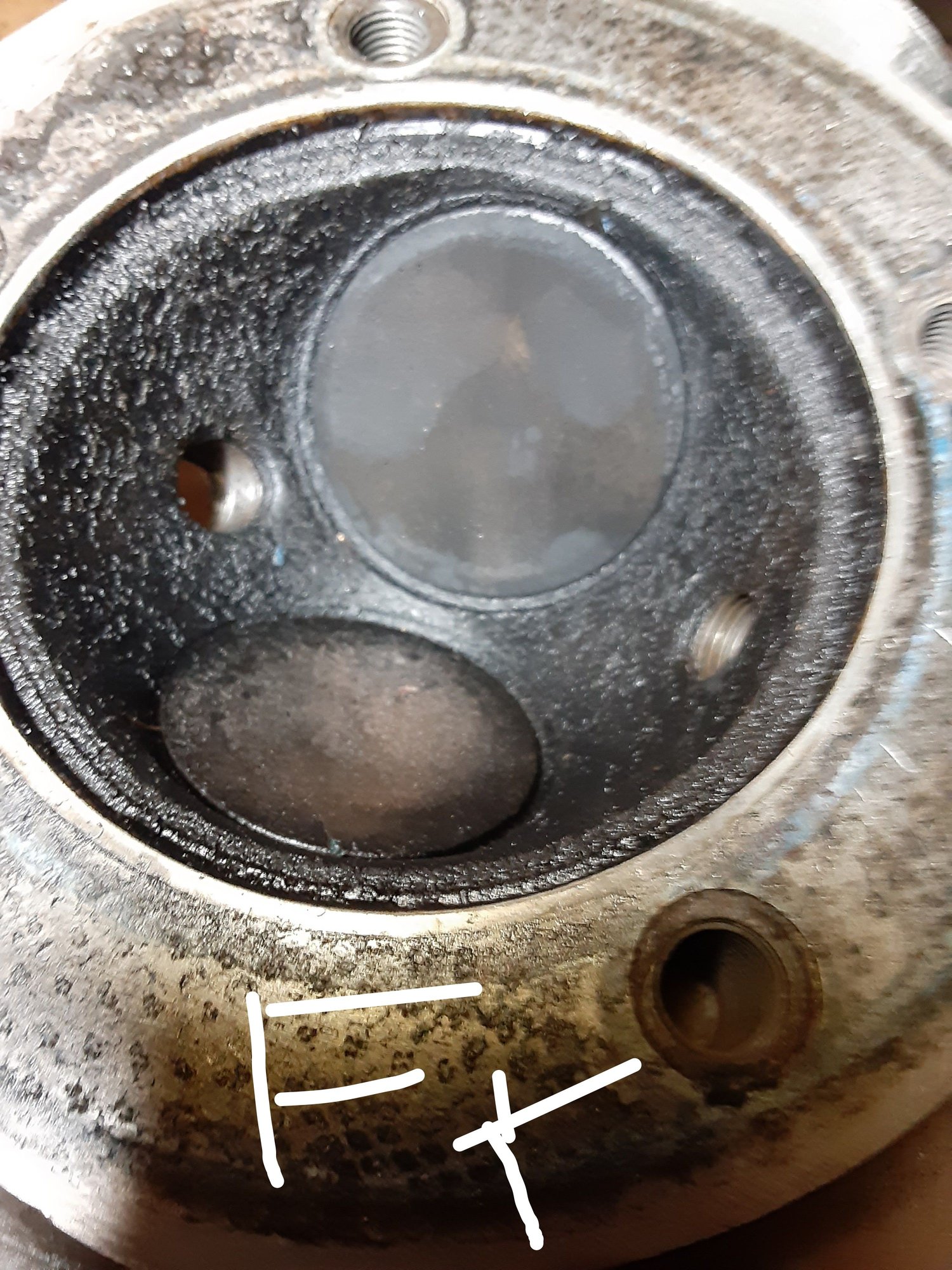

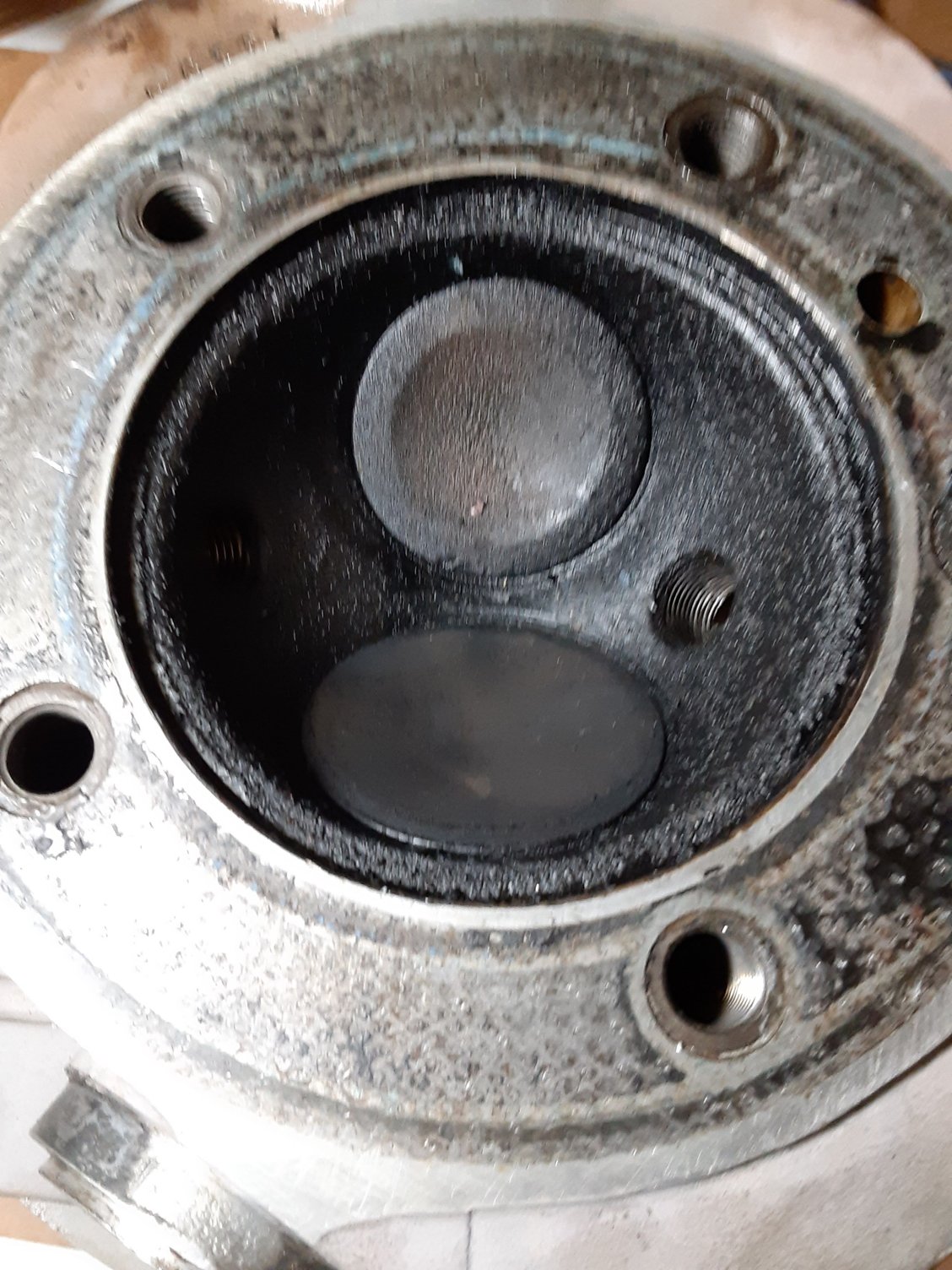

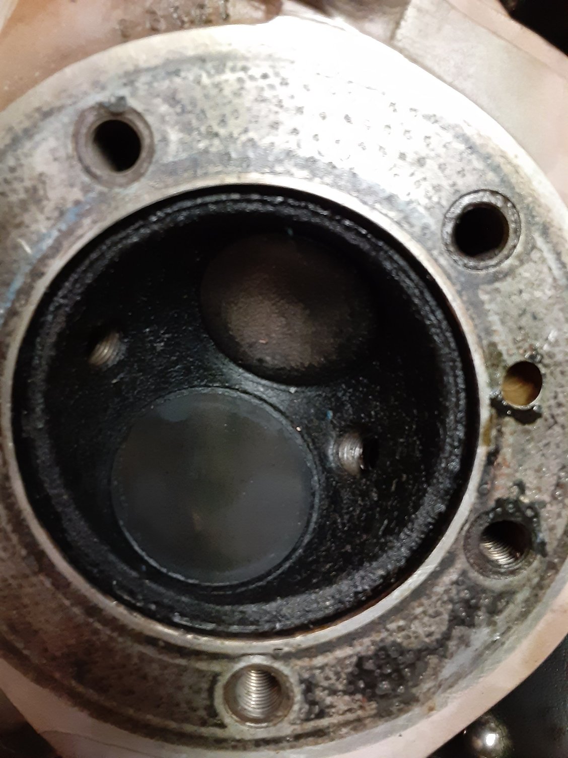

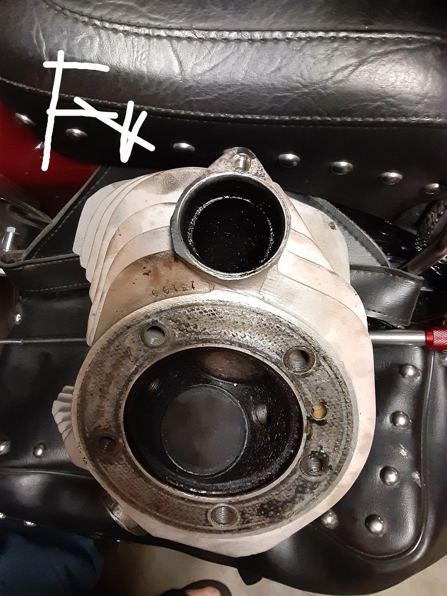

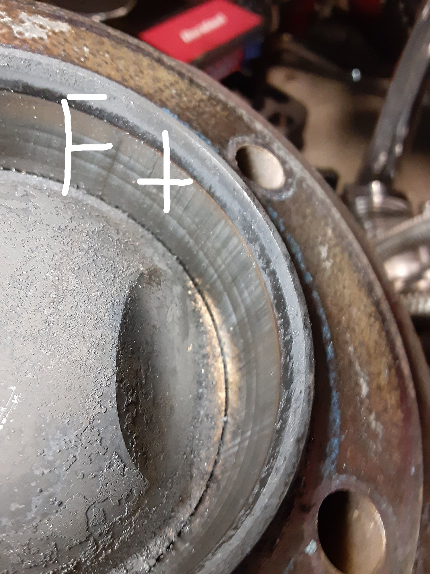

To Everyone that left answers and even the smartest ones thanx a bunch...
Hopefully I'll get the ol girl up and running soon. The lower end feels fine.....Look at the Pictures and let me know what yal think go back and reread what has been put....No Marlboro was hurt while filming this shoot....

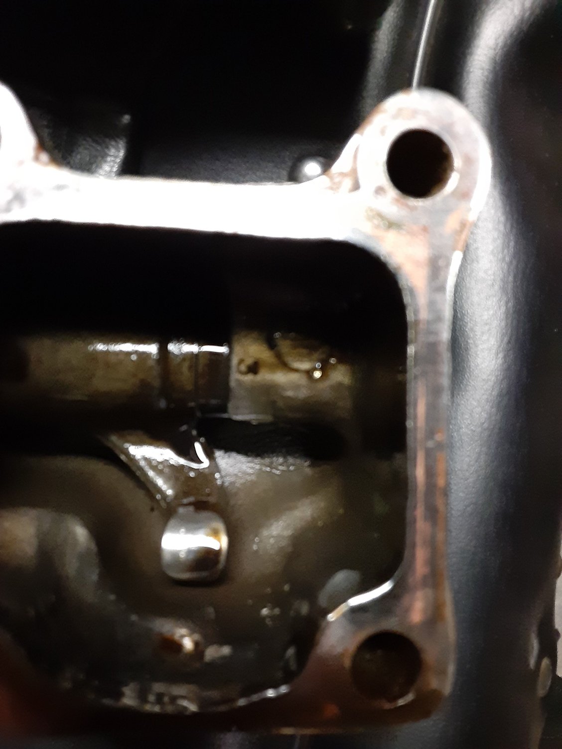

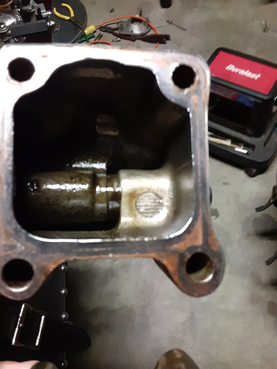

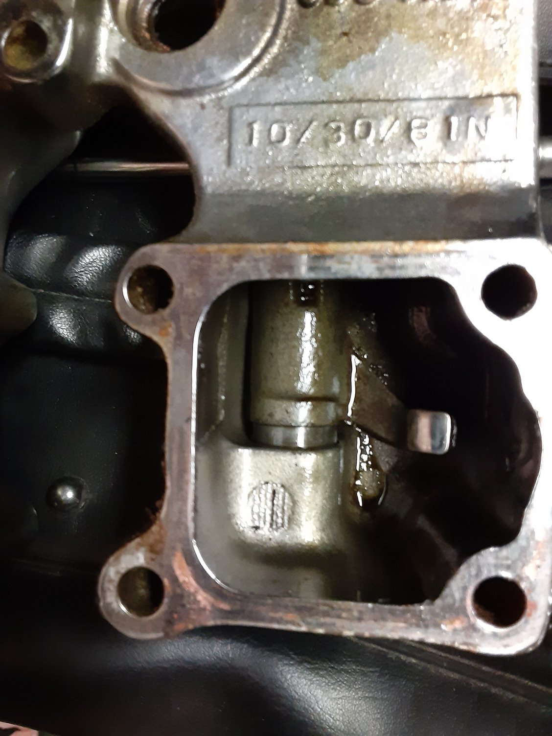

The Rockers for Ft and Rr are fine everythimg looks feels fine. Will replace washers

To me its valve guides worn or the seals are tin and stopped working
the rubber seals require late lower retainers and different valve springs as they are lower and drops the pressure - but they work the rubber seals

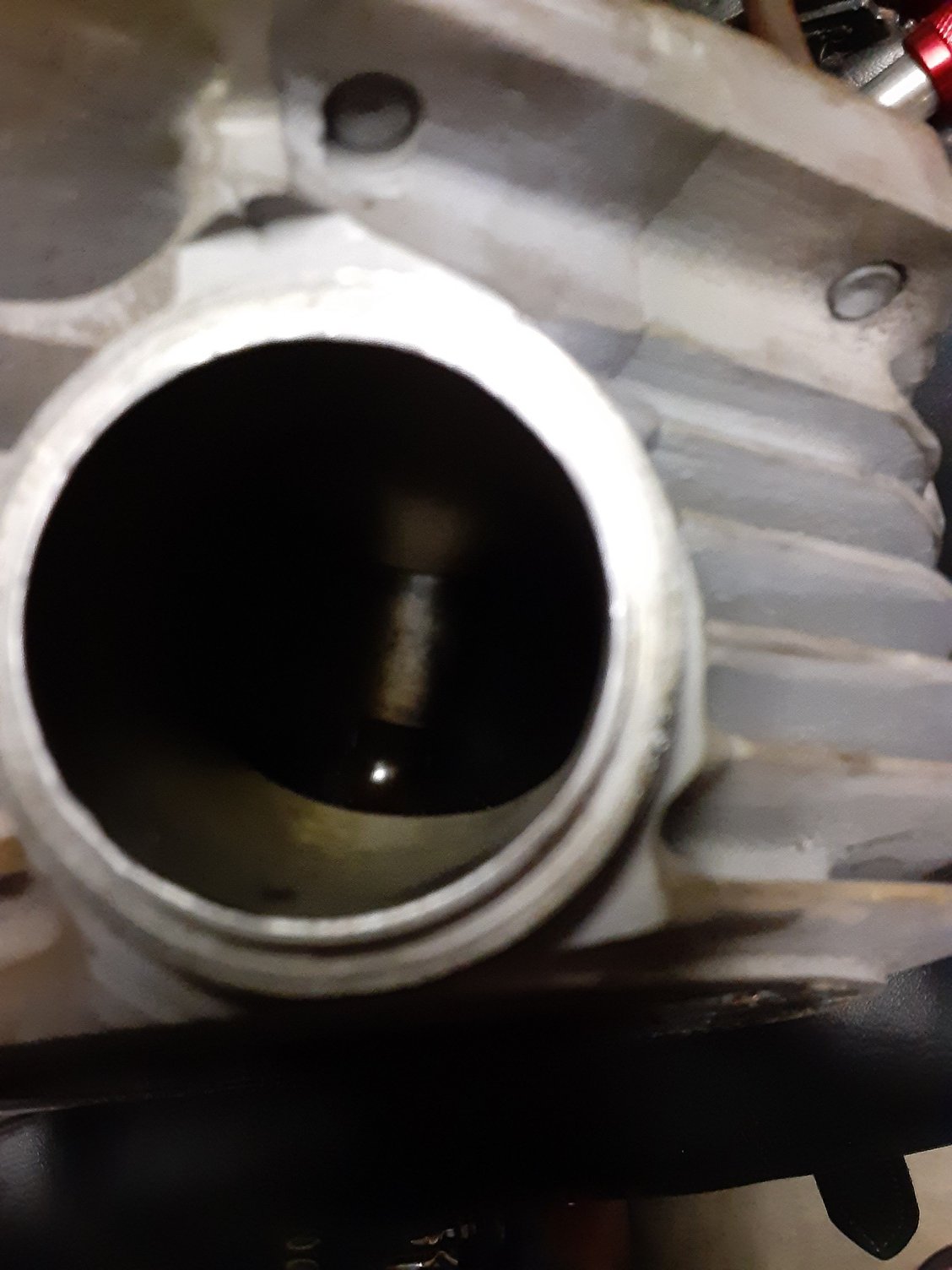

Okay got everything off. Pistons, Heads, found one valve guide was broken on the exhaust front where the oil leak was coming from.
Don't understand why it was leaking on the Rocker gaskets they were metal.....and the Head gasket top was Fire Rings...paper gasket for bottom base jug. Everything clean up ready to take it to shop. Pistons are ready...Don't have the equipment to do the heads or finish the jugs. Hopefully it won't cost me a arm and leg to finish her. Have the stuff to put her back and running.
