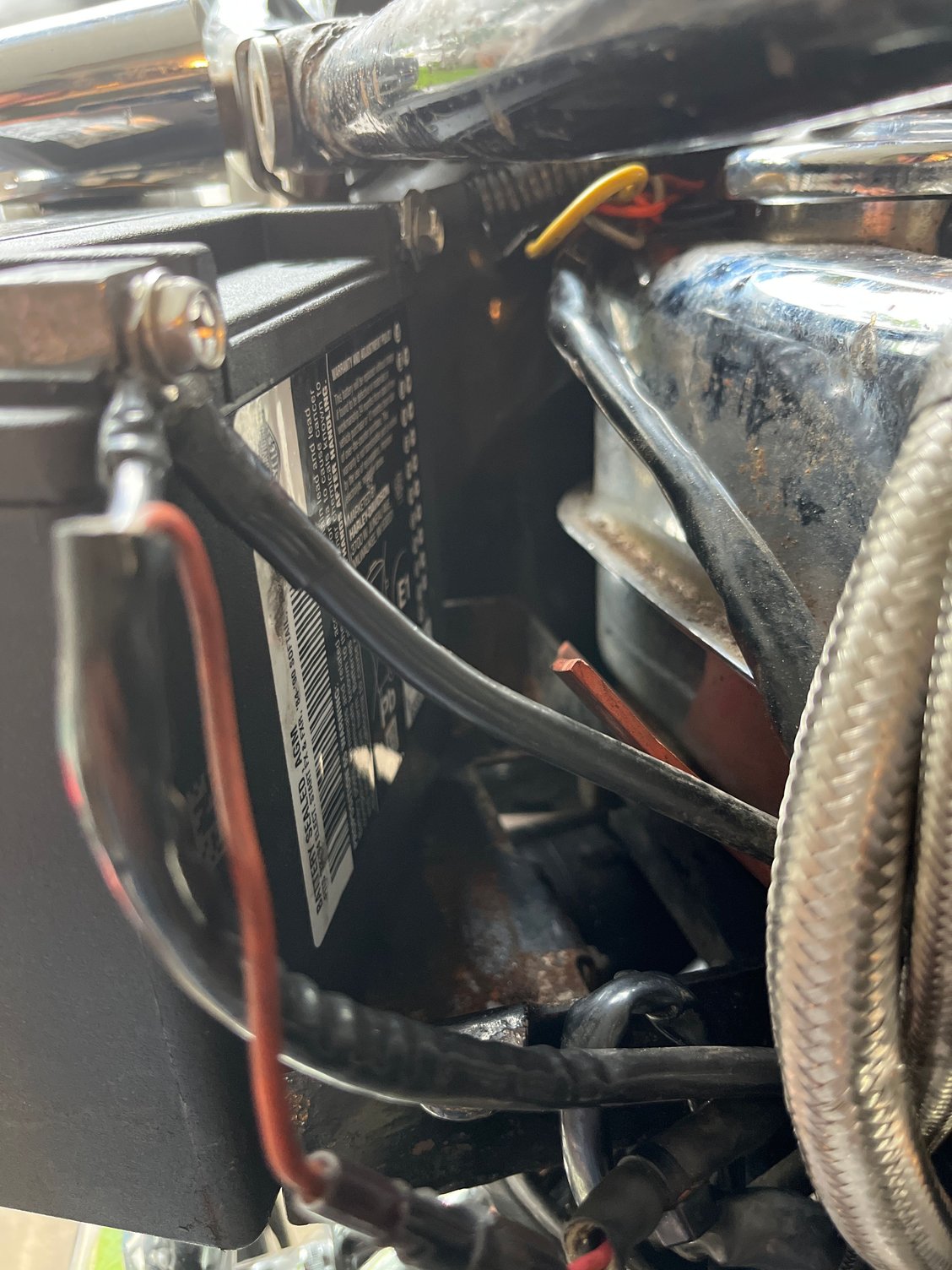

I was out riding today and my battery post broke off. So it died at the gas station. Managed to get a new battery put in her but now I have no power. No lights. Nothing. Any ideas on where I should start checking?

Pos or neg "fell off"
If pos, is yer Regulator hooked to that post??
1st place I look for 12v, is the Main Breaker on pos post

Look at the last thing anyone touched - are all the wires connected to the battery or did one slip out of sight?

Just double checked. All the wires are back as they should be.

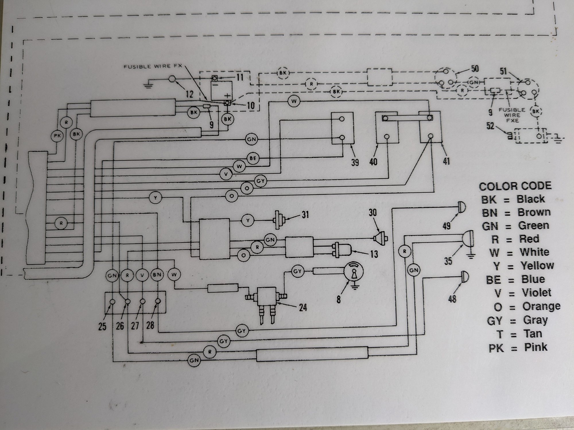

looks like you got a fusible link in the red wire, if its the power wire to the dash i would check there too . . .
