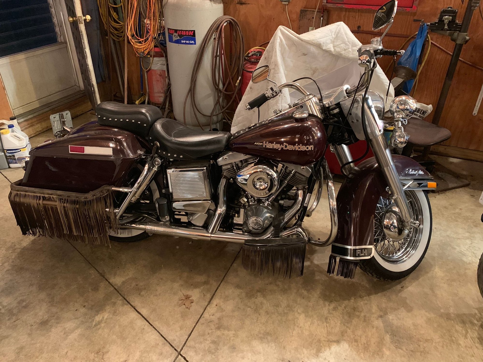

New to the forum here and looking for some guidance since I’m not too familiar with older motorcycles. My questions are probably basic, but I’m sure I’ll have more - just wanted to introduce myself here.
I have a 1978 Electraglide with the 80 ci engine. This bike was left to me a few years ago when my dad passed. It was his every day bike so he took great care of it, and I plan to keep it that way for the rest of my life. The issue is that I always rode sportier bikes and, regretfully, figured I had more time to learn from him about this one.
I’ve made sure to start it periodically, but there are a few things that have held me back from riding it as much as I’d like.
It needed a battery, and I had issues finding one, so I ordered one online that I had to add the acid too. It didn’t hold up great.
Another issue is that the front brakes are completely gone - no resistance. I’m not too sure where to start there. Im guessing I should get some fluid back in to see if the line is leaking?
I do have the manual - I just feel like he was always talking about extra things he did to maintain it since it was an AMF year.
To simplify my newbie ramblings - my questions really are:
  1. Where do I start with a front brake issue? Fluid, master cylinder, caliper?
  2. Any recommendations on these big *** batteries? Or should I just make a trip out to a shop that specializes in older Harleys?
  3. What’s the best engine and tranny oil I could put in this bike? I think he went a heavier weight than the manual said. I’ll look around the barn next time to see if I can find an old bottle.
I’m sure this is all obvious and basic to most of you here, but I’d appreciate any help I can get. Thanks!

welcome to the forum.....thats a nice looking bike you have inherited from your father , it looks like he cherished it. Battery ... i use a motoblat mbhd12h. brakes try bleeding first then calliper, then master cylinder, saying that though it sounds like the whole lot needs a good service. oil most here ( but not all ) will agree on 60w / 50w both engine and transmission.

nice ol bike
