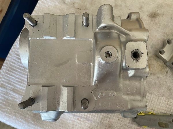

For me anyway, the best way is to pull the transmission, gut it, have the drain plug hole filled, drill and retap hole for 1/8-27 NPT with a magnetic drain plug. Those original thread holes are most likely really worn out and things like teflon tape and pipe top are not going to solve your problem in the long run. Another option is to use an oversize plug. Places like V-Twin sells them.
