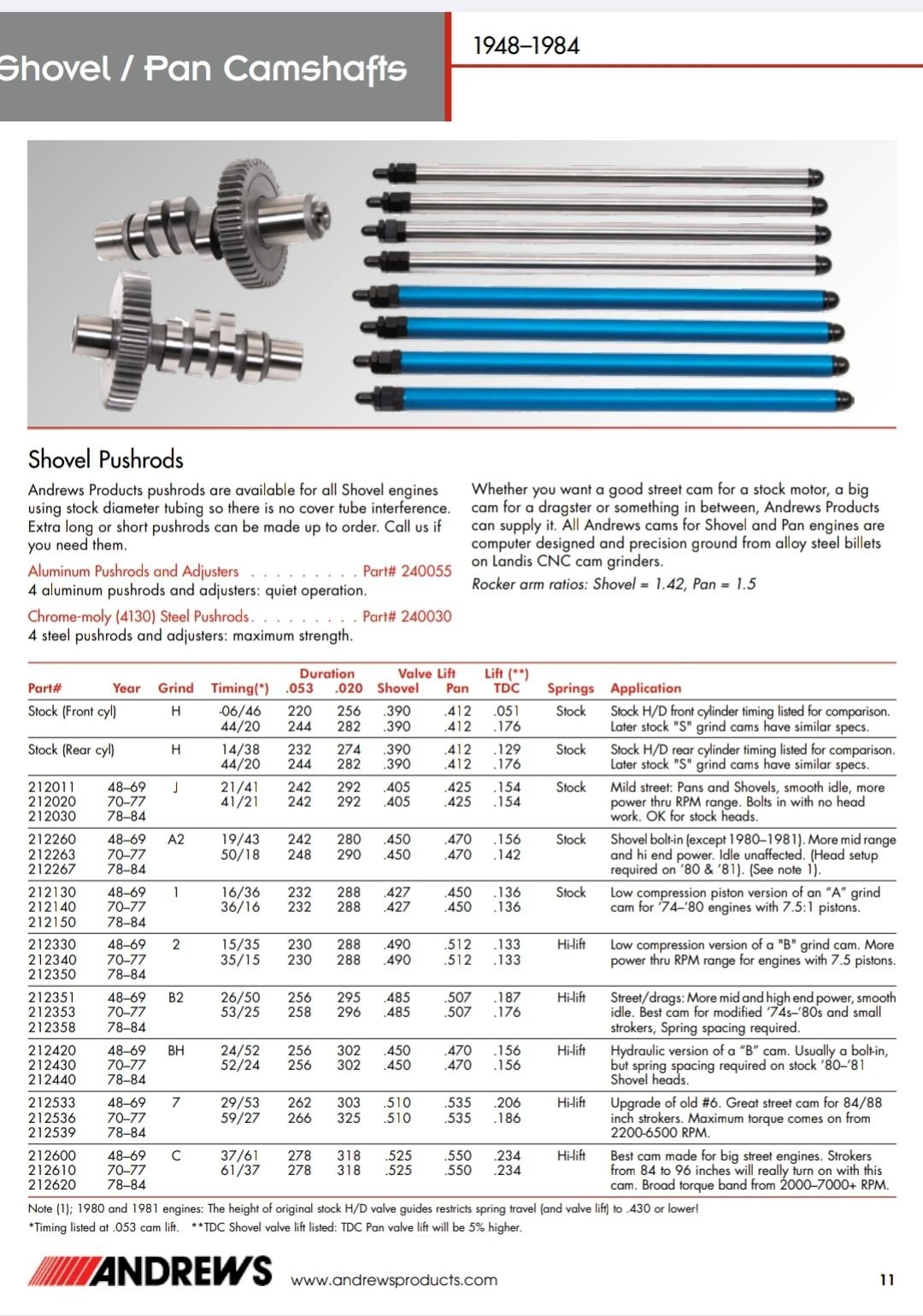

The A2 should be bolt in to your 84 heads.. Read the note at the bottom of Andrew's cam spec sheet list.. It's always good to measure though..
A2 is a very good cam for the Shovelhead...
The 2 cam is one of the best for stock configuration but will need head work.. I ran one in my 77 and loved it.. 68/72 hp/tq .
