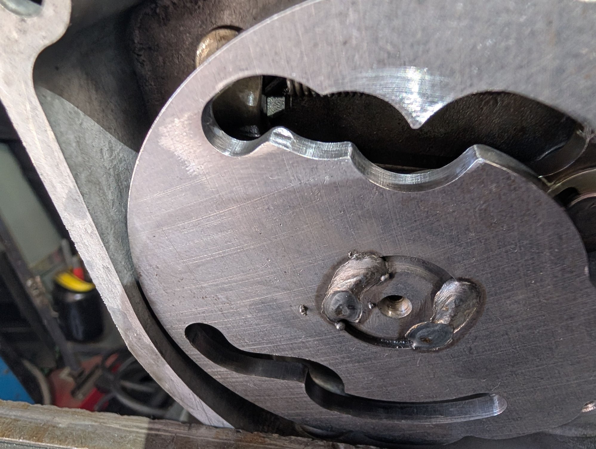

If the linkage is good and the hat isn't sloopy I'll take the dremel and cratex bits points and polish the ramps inside & out on the shifter plate, doctor the detent ramps a hair for positioning plunger. Definitely smooths out the shift's and the neutral hunt is no longer a problem. Spots like this on the plate will cause hard shifting.
