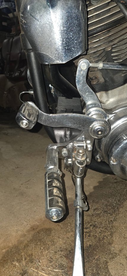

Got a picture of the forward controls you have on there now?
I'll be reusing the rear master cylinder.
