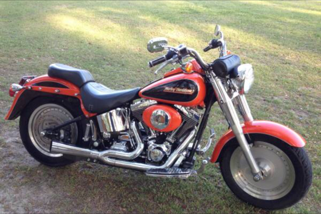

post a picture i like harley fatboys i have a 2010 fatboy lo

nice bike good luck

First - find a painter
Yes, the color is a bit loud. The air cleaner cover and struts aren't things I would have painted.
Thanks for the list of things to check!

Besides the struts, ac cover, and dash cover I actually dig the color.

very nice looking ride!

Very nice, I have a 2000 fatty. I really like the early carbd twincam fatboys.
