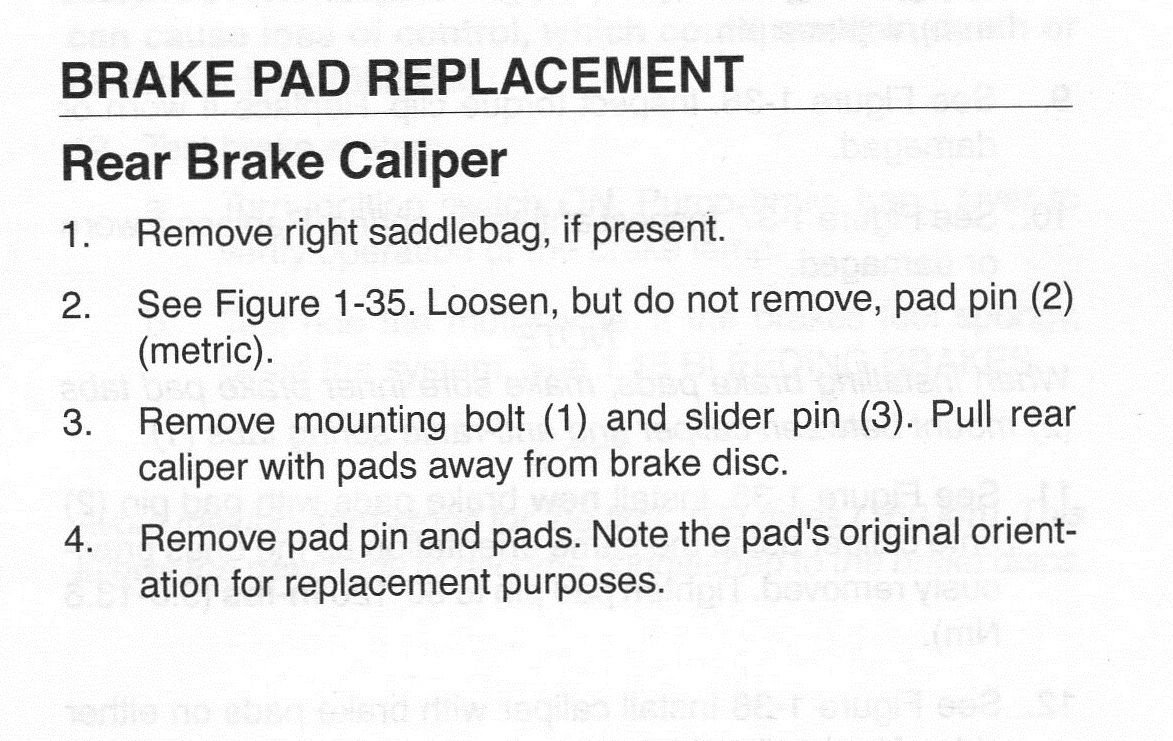

Hi
Silly question but bear with me!
I need to replace the rear brake pads on my 2009 Heritage. I do not have (but will purchase!) an official Service Manual but assumed that the pad removal would be self explanatory.
On checking today it seems that I need to remove the pin that holds the pads in place. Easy enough but it seems that the access to the pin is obstructed by the swing arm down tube.
Does this mean that I need to remove the caliper to then remove the pin or is there some secret that I am not seeing?!
Any top tips/procedures would be most welcome!
Many thanks
Jules

Might be just as easy to remove your caliper if room allows, 40 torx for caliper and 1/4 inch for the pad pin.

I would pull the caliper...makes it alot easier.

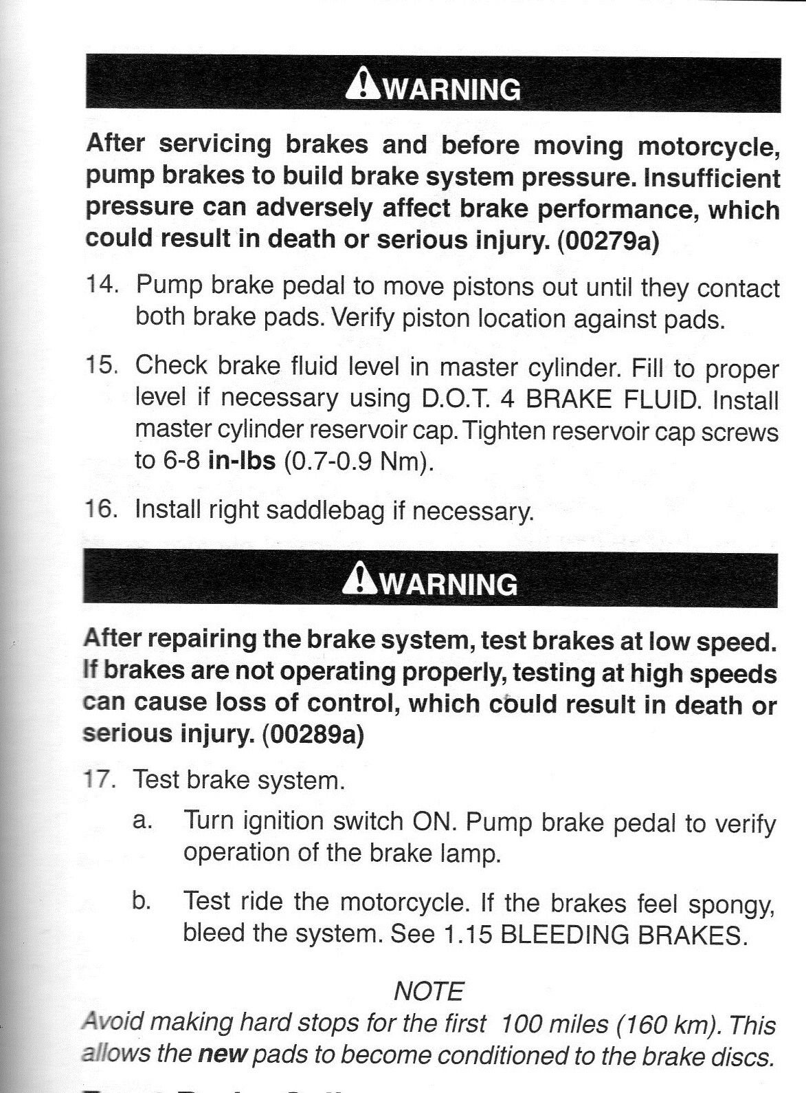

Old May 15, 2015 | 04:49 AM
S.D.M.F's Avatar
S.D.M.F
Joined: Nov 2011
Posts: 1,397
Likes: 403
From: Australia
Old May 15, 2015 | 04:50 AM
S.D.M.F's Avatar
S.D.M.F
Joined: Nov 2011
Posts: 1,397
Likes: 403
From: Australia
Old May 15, 2015 | 04:51 AM
S.D.M.F's Avatar
S.D.M.F
Joined: Nov 2011
Posts: 1,397
Likes: 403
From: Australia
Old May 15, 2015 | 05:09 AM
Julesx's Avatar
Julesx
Joined: Apr 2012
Posts: 40
From: England
SDMF
Many thanks for the upload! That's made it a lot clearer!! I appreciate the effort. Off to the garage....................
Jules
