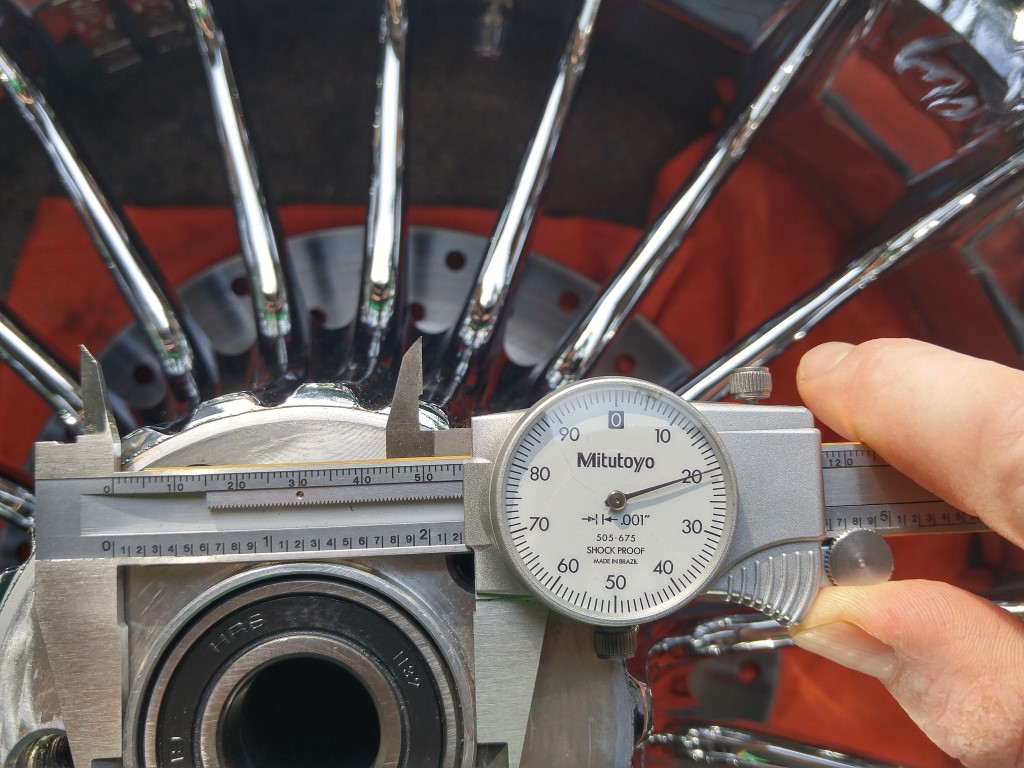

Put on the old sprocket and drove it about 30 miles and not a peep. But I still have to figure out the exact problem. But that's up to me. You guys have helped unbelievably!!!!! The new rim sprocket lip is too wide. I attached pic's showing the old versus the new. I got home and placed my cvo sprocket onto my old rim lip and it fell on like the original does. Which told me my CVO rim's lip was too wide. But I still put the old sprocket on my new cvo rim. And I had to press it on again(by tightening it down with the bolts). So theoretically it still shouldn't work but it does. Maybe they have different metal properties???? I still think it's my sprocket being too tight on the bearing hub and not allowing it to expand. But putting on the old sprocket which is still a press fit should cause the sound to still be there? But again, I will worry about it now. I have my CVO sprocket being machined right now to fit over the lip like it should. But it is either the Rim or sprocket that is defective. I have a ugly black sprocket on my beautiful chrome rims but at least I can ride!!!!!!!!!! Thanks all again
I do have one question though maybe you guys know? why does my sprocket have one hole tapered? I just noticed this. And can't figure out why??? Does anyone know why?

The new wheel sprocket hub OD is obviously just a little larger, and machining the new sprocket hub ID should sort it out, IF that was preventing it from going all the way home.
How do the two sprockets mounting hub thickness compare?

it goes all the way home. That was never a problem. Just had to crank the bolts to send home.
I never measured the hub thickness. But I put both on a flat bench side by side. And the inside of the lip that the belt rides against was the exact height. which should be the most important part. Is that why you were asking about that measurement??? to see if the belt location would be the same? if so it is.

it's literally 1.2 a millimeter. just run a dremel with a grinding wheel along the inside lip of the sprocket till it slides on easily.

I actually deal with machine shops at my work. And one took it this morning and is doing it professionally for me.
that lip is too short to effect the bearing I think. But like everything else with this problem you never know.
I just talked to my Harley guy and he seems to think it's just my old belt on the new sprocket(I have 10K on it). Once machined I will put back on and ride this time. I will ride till it either starts to get better or worse. But thank god we know what it basically is now. This has been the worst few weeks of my life!!! I can't wait to clean the thing. It is destroyed right now.
