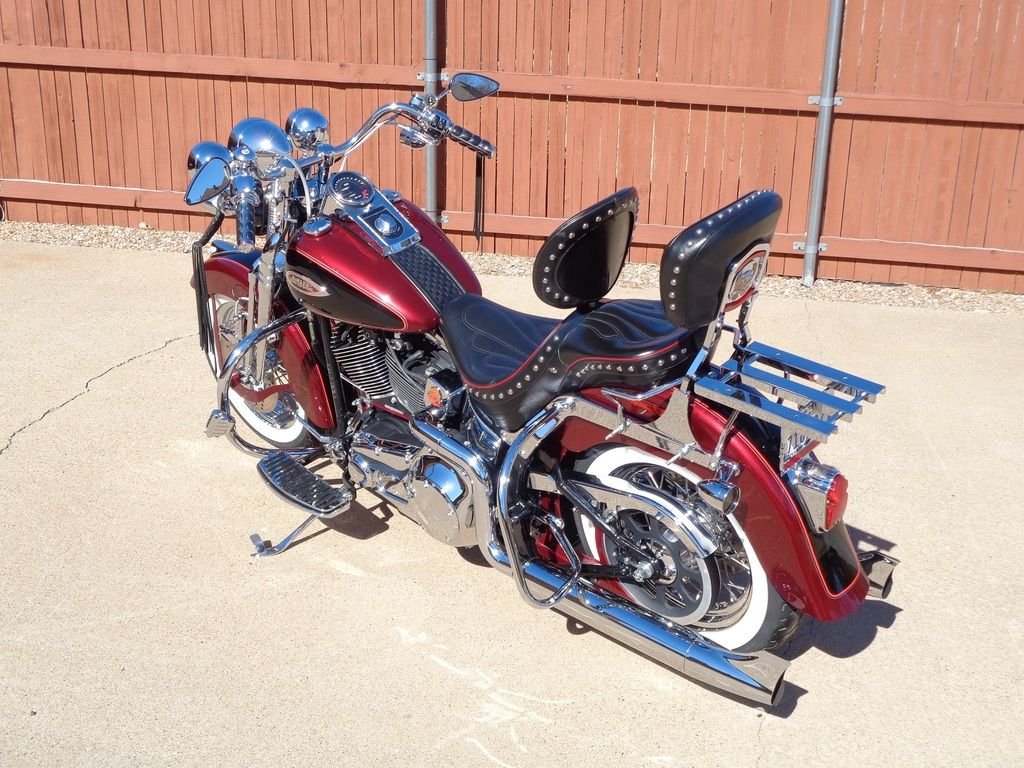

One more change to the scooter. I wanted a tribute to my Dad and Daddy-in-law on the scooter. A friend found the HD Air Force covers for my Dad. Now scouting for Army for Daddy-in-law. Probably something to put on the sissybar or primary insp cover.
For all of our veterans and active military - Thank you for your service to our country!
