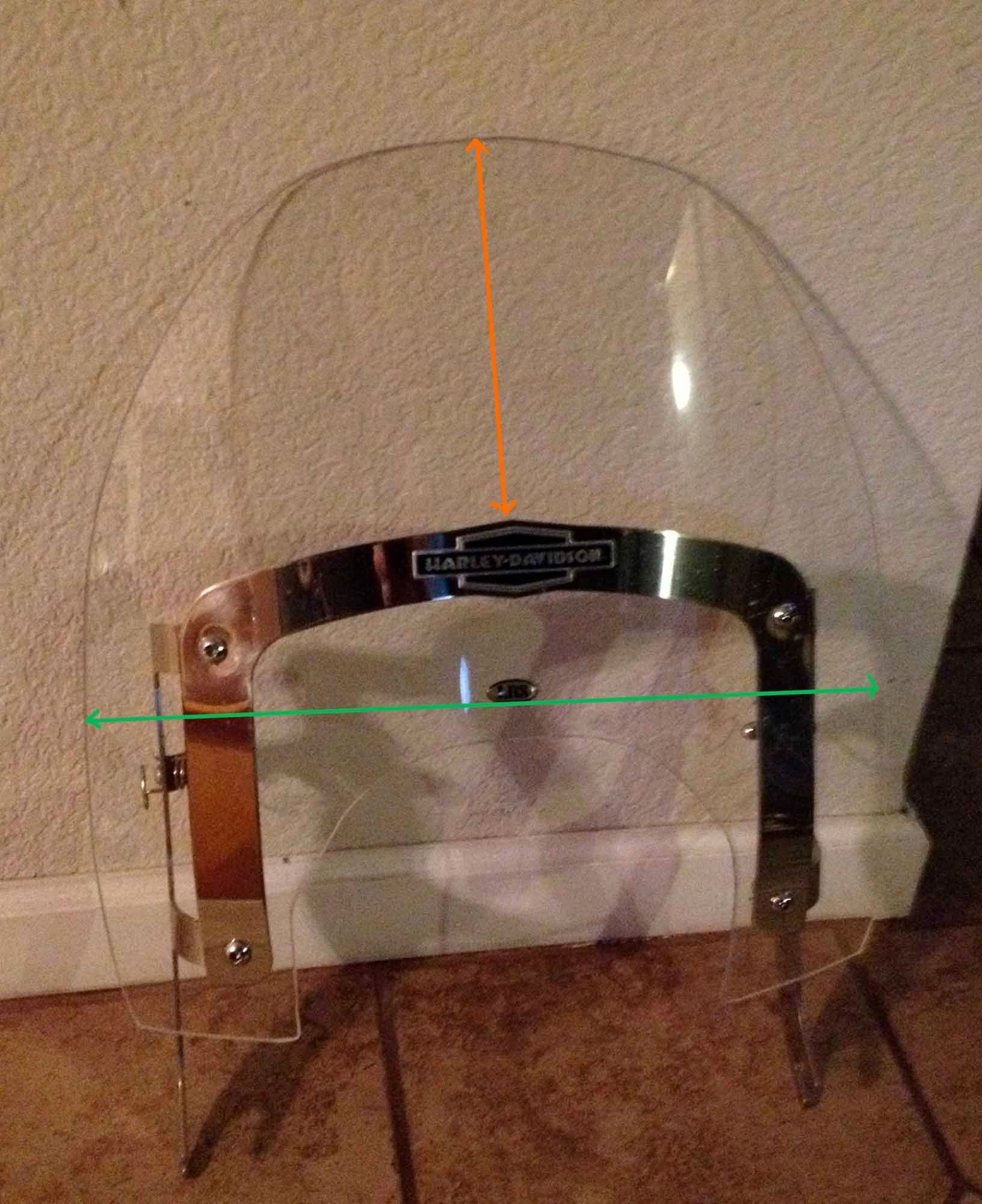

I got a couple PMs on how I cut my windshield, so I thought it would be good to post in public so anyone interested could see.
On my '06 Deluxe, I'm using the "Nostalgia" windshield QR. Referencing the photo, it is 7" from the top of the crossbar to the top of the plastic (red arrow). Then 17" wide overall (green arrow). I also had to trim the headlight hole to fit around my freight train nacelle.
If you've got a windshield screen you're not using, might be worth a try. It may not work the same for everyone due to different bike set-ups, different personal height, handlebars, etc. Aerodynamics is a funny thing.
At any rate, as I've said before, this mod cuts the wind pressure significantly to my mid section, and puts my helmet in clean air, cutting the helmet buffeting to near zero. I wear a full face helmet. If you're wearing a beanie helmet, this may not be for you. That's as good a disclaimer as you;re gonna get. But you won't know until you've tried it. The only thing at risk is a bit of time, a spare wind screen, and possibly cutting off your fingers if you're a total clutz. Proceed with caution!

Thanks Again, Mike!
I think this is a great idea, and I appreciate you taking the time to measure your 'shield for those of us that may want to try this mod.
I always wear a full face helmet, so this may just work for me.
