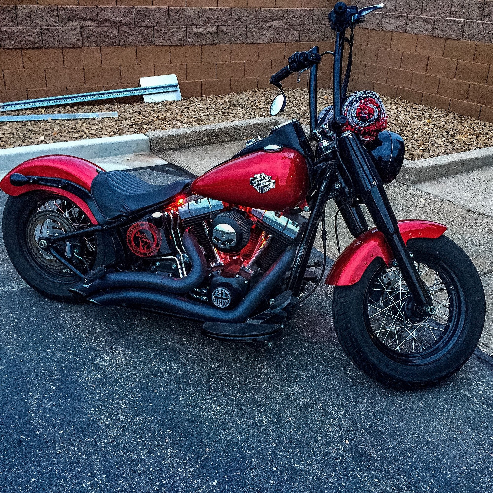

I did it this way $15 bucks will drop it 2"
https://www.ebay.com/itm/371405642992
