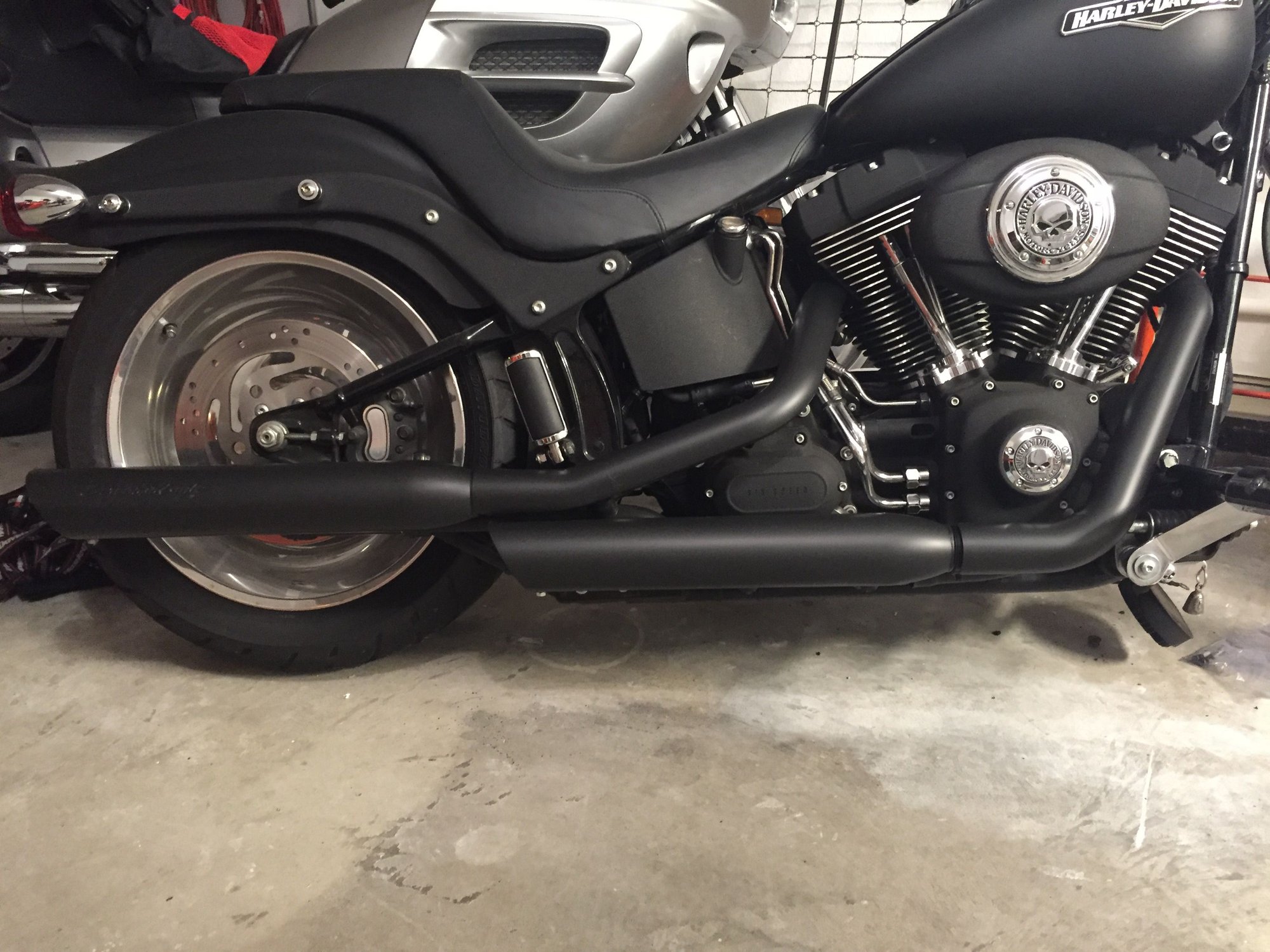

I used Progressives w/RAP. They have worked well on my Night Train. Do not get the heavy duty shocks, I weigh 160# and I have them as loose as they will go to get some semblance of sag. Normal duty shock will do unless your a really big dude riding 2 up all the time. I also used the Progressive cartridge inserts to lower the front as well.
Here is a close up of mine after lowering. I have an indy mechanic who is a Night Train fanatic and this is as low as he recommended to lower with Progressive shicks.

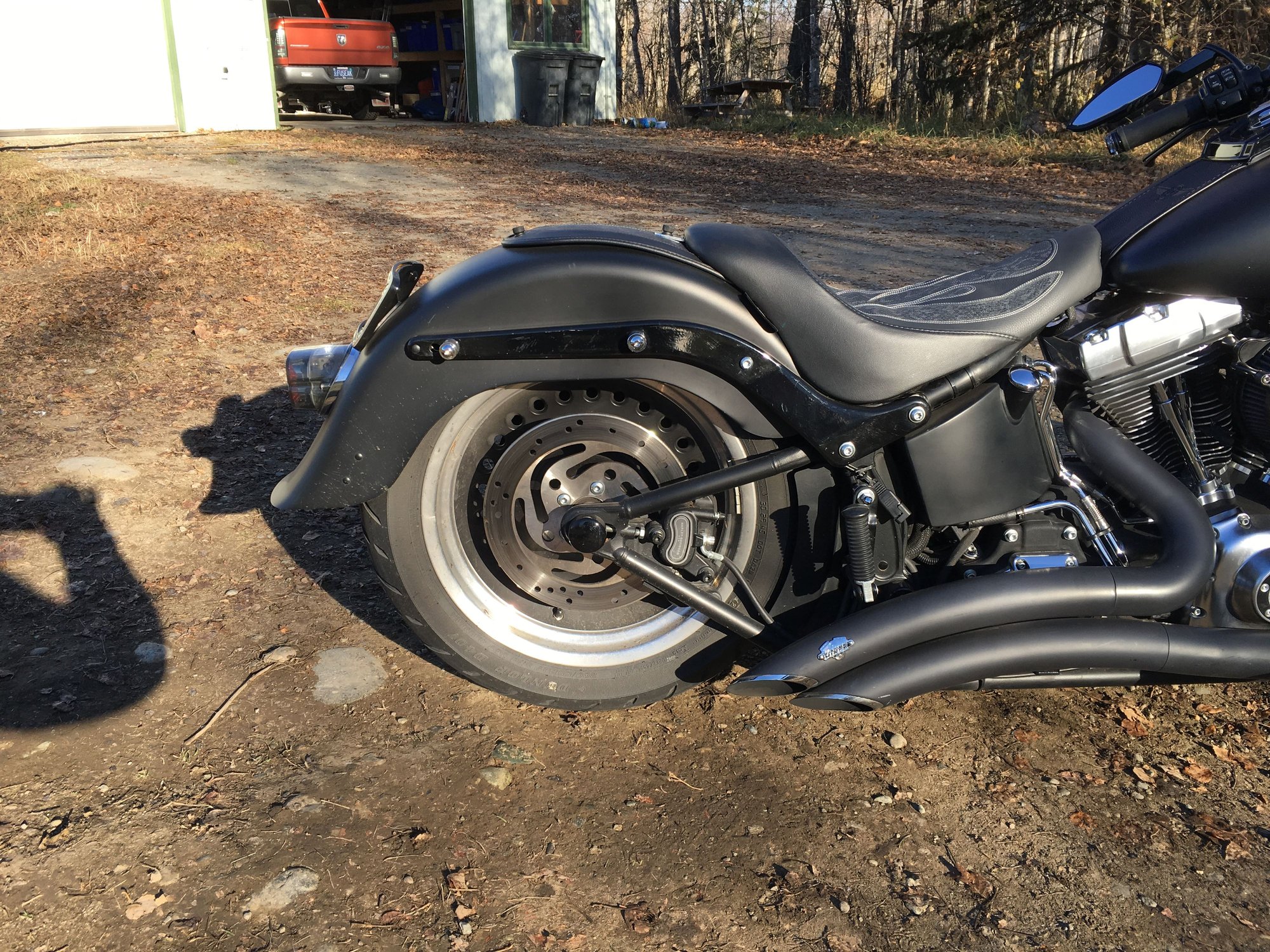

Heres mine with the softailloweringkit.com 2" kit. I really didn't notice much difference in ride. I want to do an air ride kit one day, but the 4x4 look had to go immediately.
