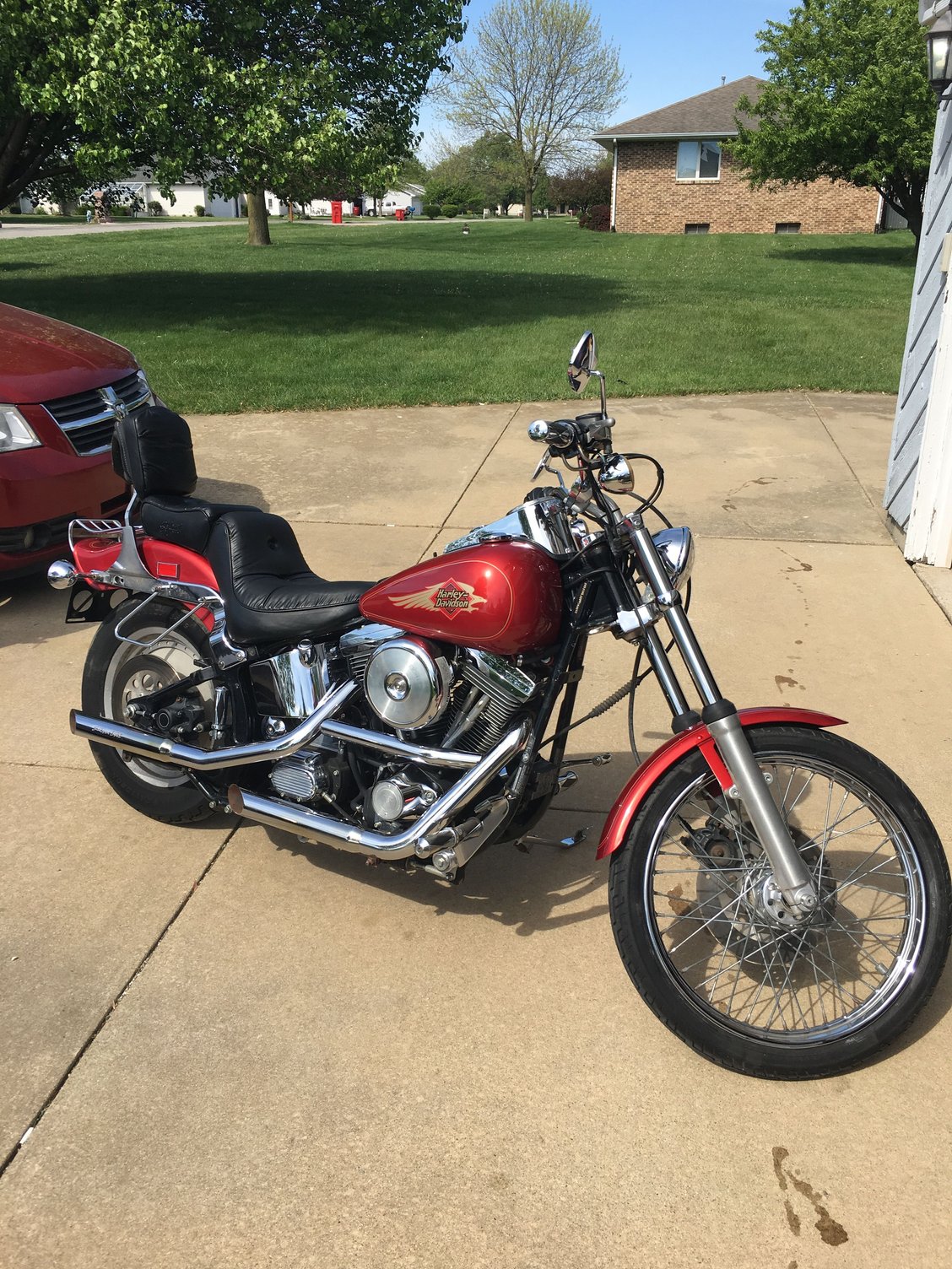

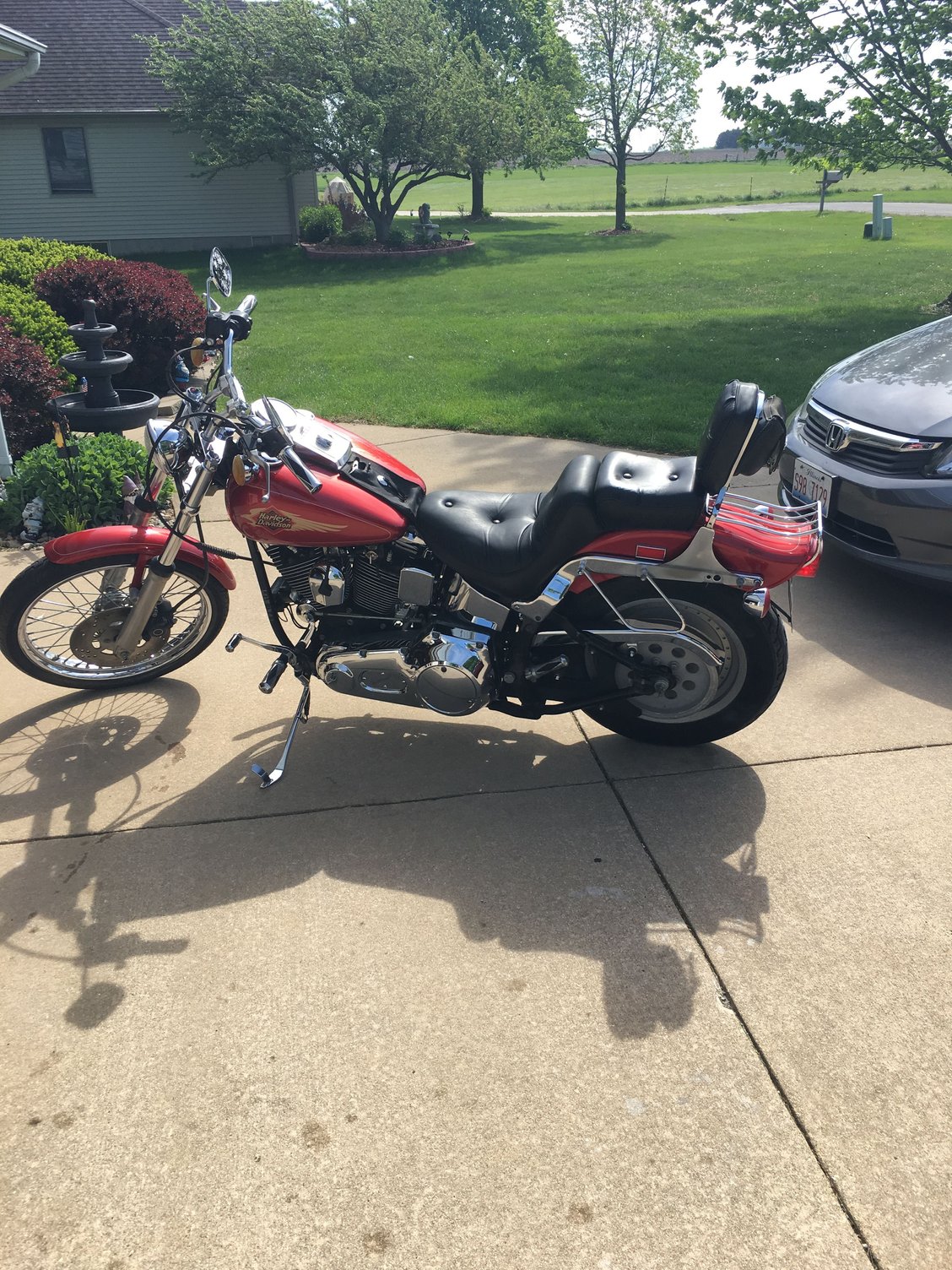

Before
After

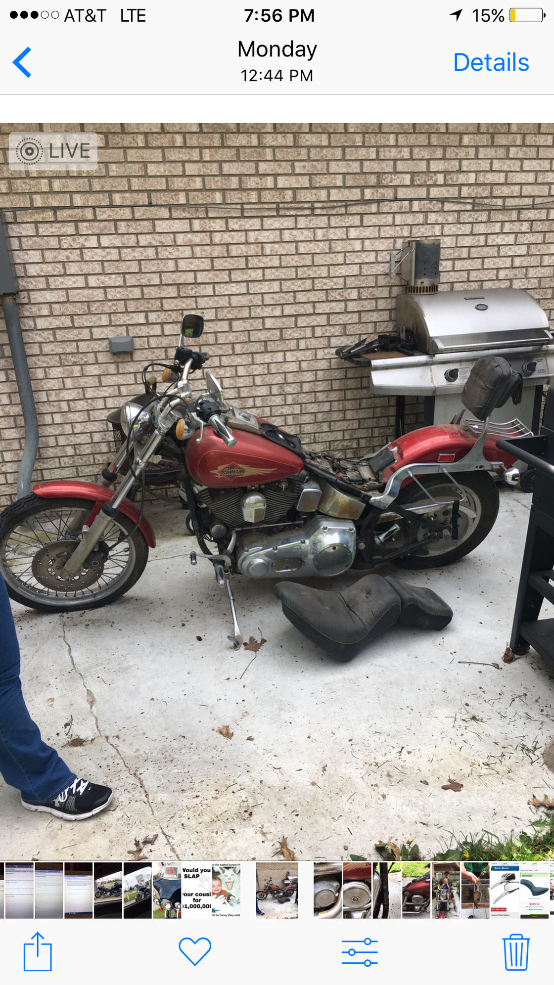

BigMike@1984's Avatar
BigMike@1984
6th Gear
Joined: Apr 2017
Posts: 13
From: Illinois
Before.......
36 hours later
