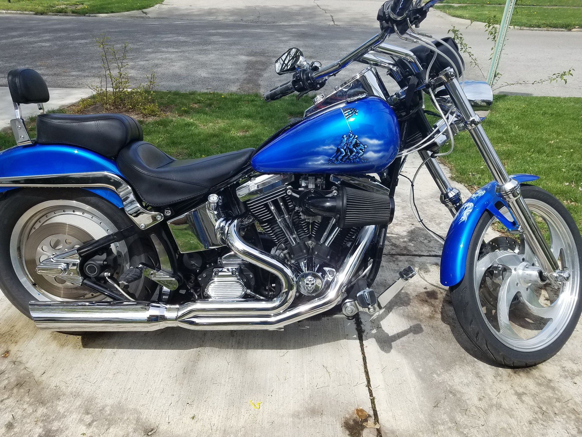

Neutral light stays on or flickers. 21 yr facelift complete, except for this minor problem. Manual does not show in index. Wanting to repair or replace before Ohio Bike week.......Thanks in advance. Russ

It the small switch on top of the transmission. Probably gummed up. Only wire on top...
http://partsfinder.onlinemicrofiche....ING%20ASSEMBLY
