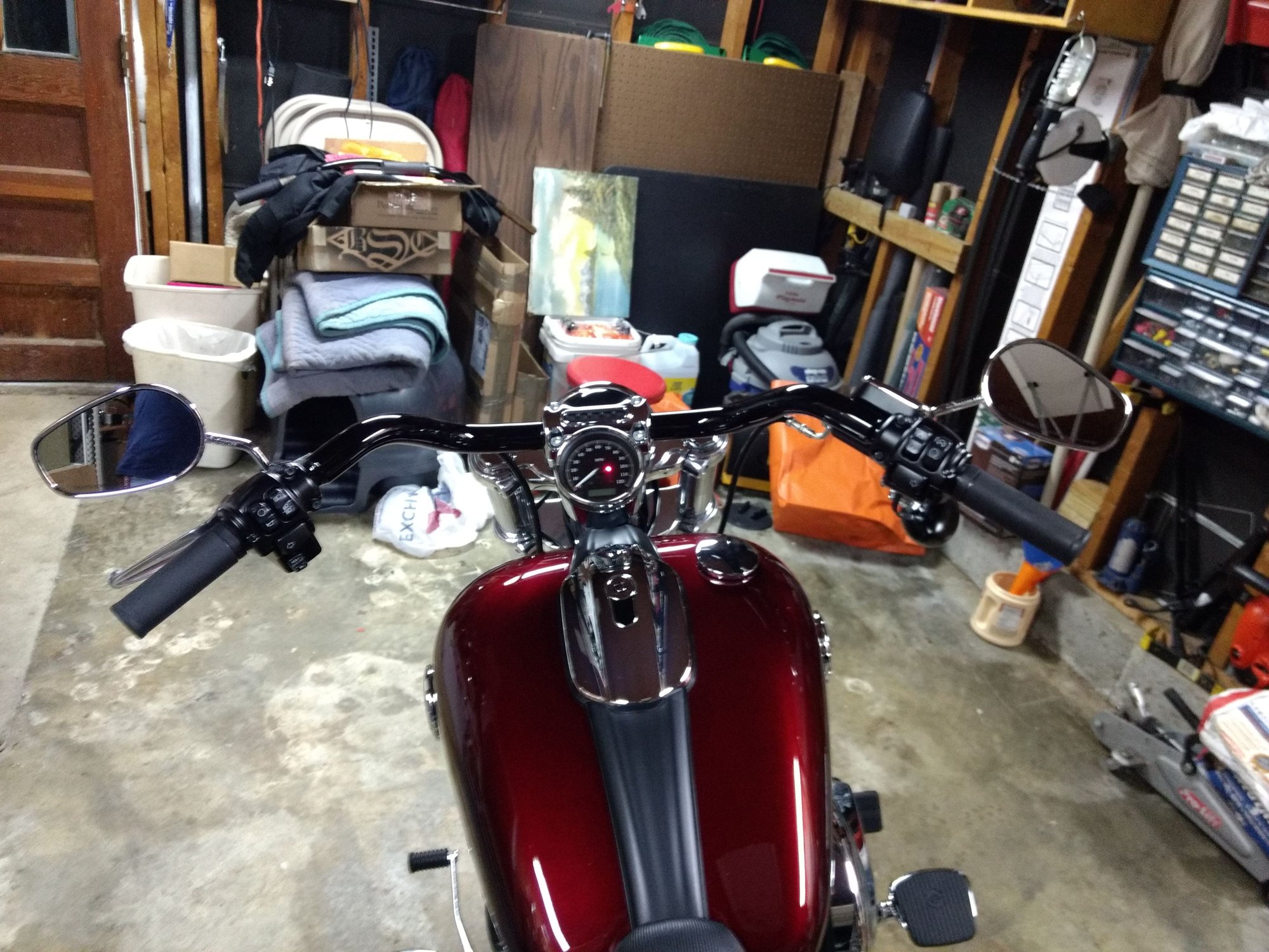

You can also use alcohol based hand sanitizer, its nice and slippery and will evaporate. Ive also used (keep it clean) KY Jelly, its water soluble. After I run the wires I used a bottle of rubbing alcohol to flush out any residue. DO NOT USE ANY PETROLEUM BASED LUBE, WD40, Vaseline or the like. Petroleum products can deteriorate wire insulation. I know a lot of guys have used them without problems but why take the chance.
Mount the bars and have a helper to fead the wires, and like said above, be patient.
I used these bars on a different bike and ran the wires inside them, these a 1" with, as you can see, some pretty tight corners.
