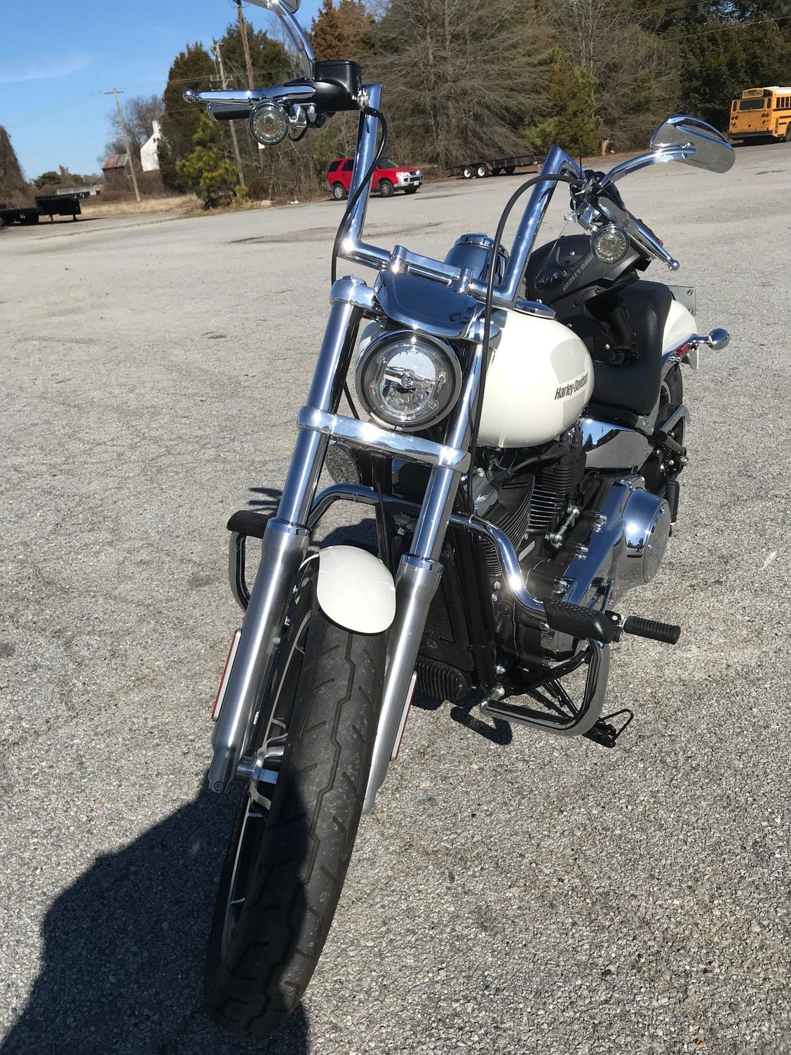

Originally Posted by Burbur2
Thank you guys. Any chance I can see pix of this 10” handlebar? I would like to see how it looks like
Sure, here ya be. Not great pics, some guys here are great photographers and take pic's by lakes, mountain streams, forests. Me? An abandoned grocery store parking lot. This was my first ride after putting them on, I snuck away from work at lunch time Tuesday. They made a *huge* difference. Bike feels easier to control and I didn't get the tingly sensation in my right wrist and thumb like I did with the stock buckhorn bars.
With the 90 degree angles, I removed all the connectors from the wire harnesses and used plenty of cable pulling lube. That stuff is slicker than snot. Bars with a gentler bend you might be able to pull the wires with the connectors on. It took about a couple hours to get the wires in there including cuss and smoke breaks. It's a dang good feeling to see the end of the wire bundles come through that center hole in the bars.

This is about right where I would like to be with new handlebar. Thanks. What did you use as pulling lube?
