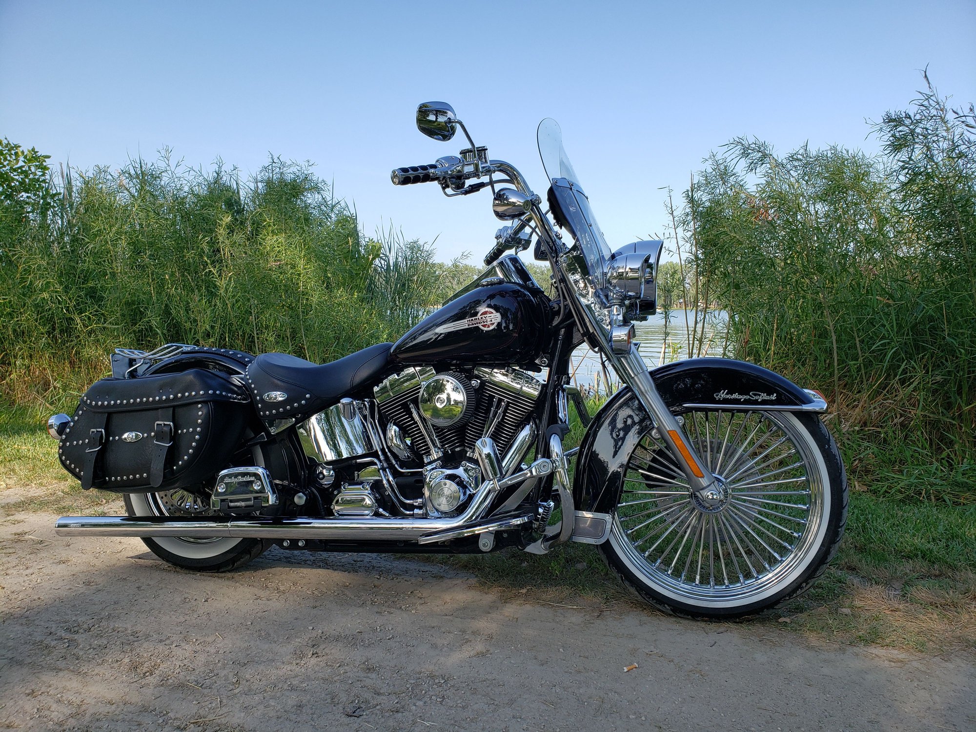

Many will tell you the advantage in lowering is in the handling, which only makes sense as you are taking it back to manufacturer levels. However, I have the same setup on my 02 Heritage and love the look and really don't notice the difference in handling. I believe its a personal preference...
