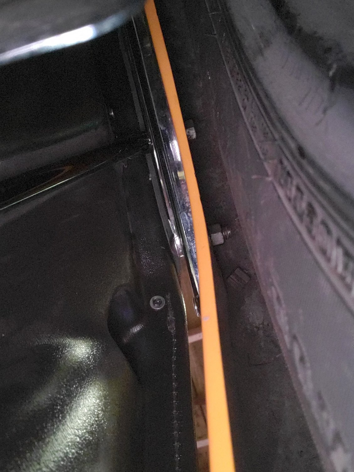

Does this stud protrude into the fender well too far?

2000 Fatboy with heritage bags. Stock 130 tire.

Based on that pic, it might be fine.... but... it is outside my comfort zone....
FWIW... I'd be turning that bolt around, so only the head, like the bolt next to it, was protruding into the fender well... even if I had to remove the rear wheel to do it...

dont have to remove the wheel, Thread some dental floss through the hole from the outside, tie it around the threads of the bolt and pull the bolt through the hole easy peasy

pull the bolt and take to the local hardware, pick one up that's 1/4" shorter. Cost you $0.23 in effort. Maybe a locknut too.

That is not right replace it with shorter bolt. Low tire would like not end well.

My go to tool is a Dremel with a cutoff wheel. Custom sizing is no problem. However, I installed bags on the fender rails of my wife's FXDL with a rivnut tool.

If you can get your finger tip between the bolt and your tire you're fine

Thanks everyone. I ordered 4 actual studs for a heritage.

Good move! I did some work on a friend's bike that involved longer bolts. Long story short, it wrecked her tire.
