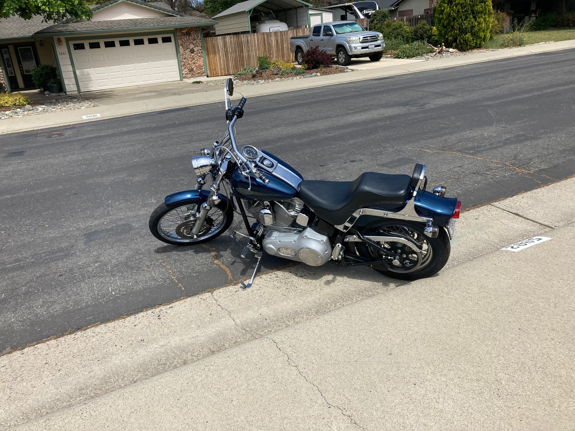

I bought a super clean 2001 FXST yesterday. Before going to look at it I assumed it was carb'd because of the year. The seller was the widow of the previous owner and didn't really know too much about it. When I got there and looked it over it had a F/I air cleaner and it sure didn't look like a carb behind it. Then I went to turn on the petcock and there wasn't one. And of course it fired up immediately when I hit the start button.
So I have a 2001 with injection which I'm pretty happy about. I guess the P/O had it converted. Is this an upgrade that is commonly done?
