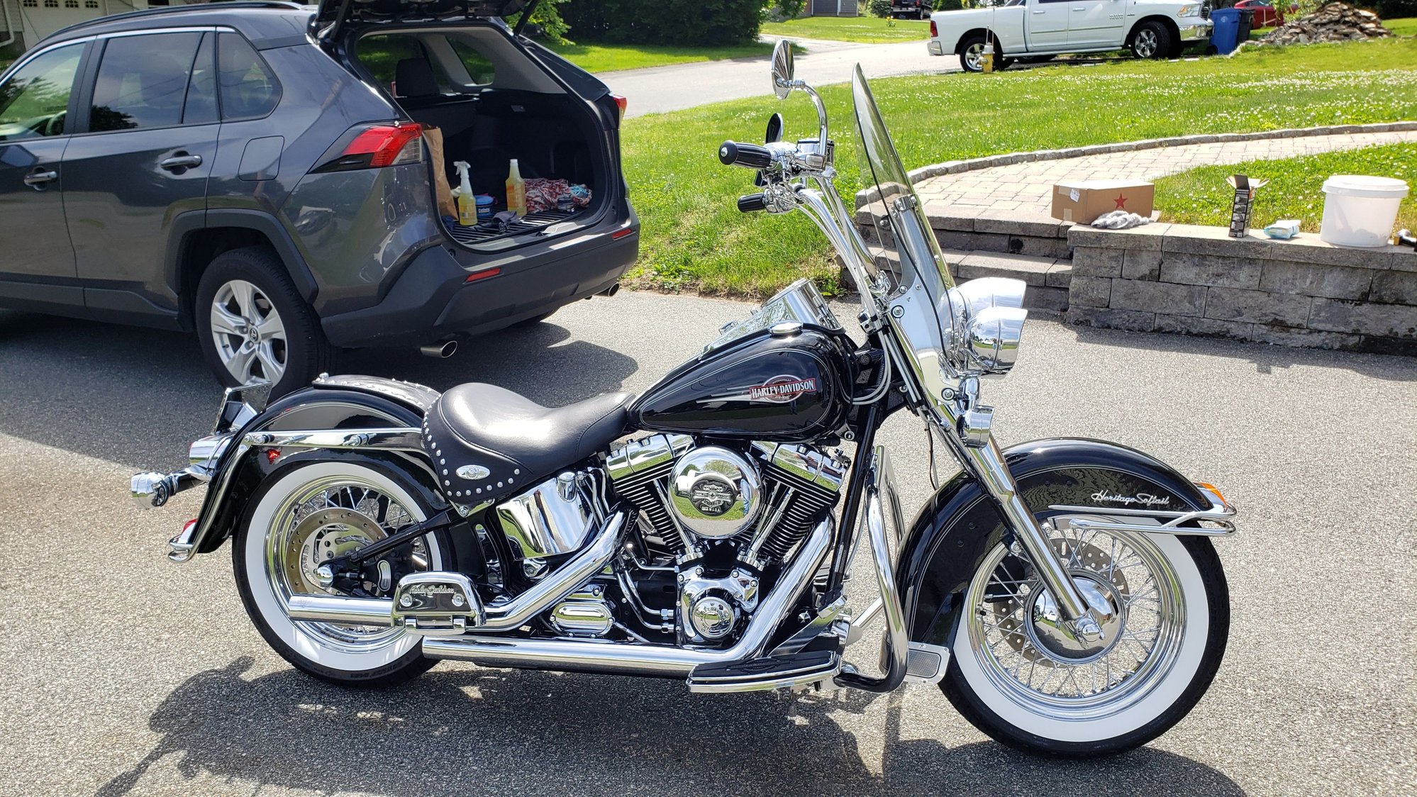

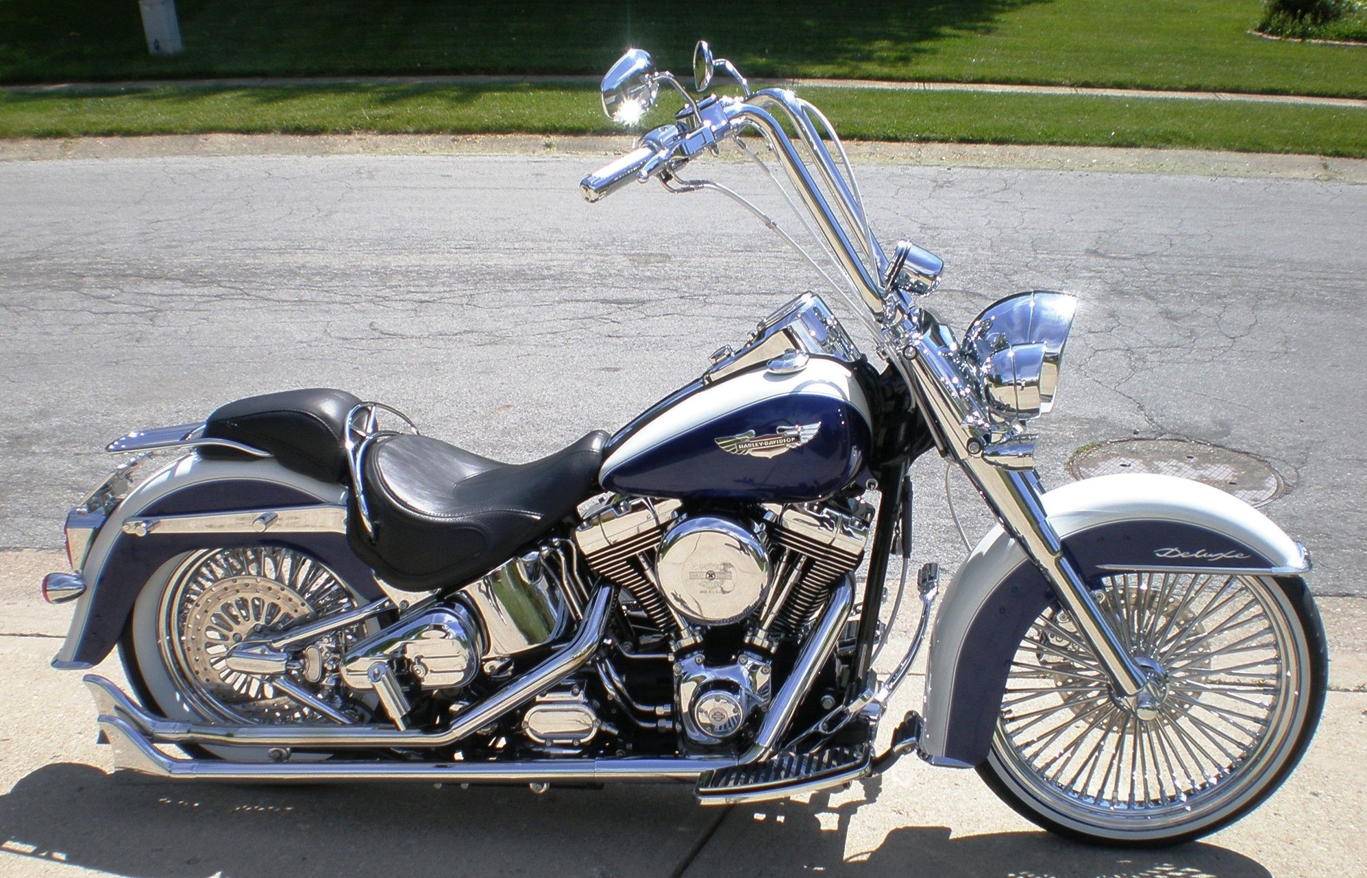

Arm length and pullback also come into play with apes. I had 16” chubbies on my Deluxe and they had too much pullback and I felt cramped on low speed turns. I sold that bike years ago but have since bought a Heritage Softail and just put 12” apes on this one. I specifically chose these bars because they have a lot less pullback and I also wanted to avoid going too high and getting pulled over. You can see from these pics the difference in pullback and how it will affect arm position and even arm height.
