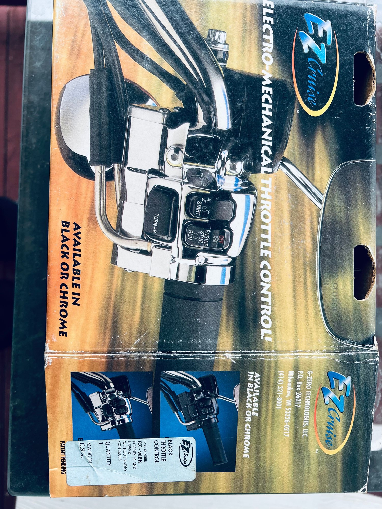

My 2000FLSTC came to me from the original owner two years ago with every box and every receipt from the HD dealer. My Softail has electro-mechanical cruise cruise control. Push button engage, either brake or throttle disengages.
What it does not do is keep your speed the same on and off hills but that is overcome by a simple twist of the locked throttle grip. Still working perfectly after 23 years
